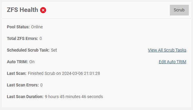

My Truenas scale shows me that the ZFS is not healthy:
When I run zpool status -v in the shell, I get this:

those errors are leftovers from corrupted files that I deleted.
How can I get rid of these errors, back to a healthy ZFS again?
