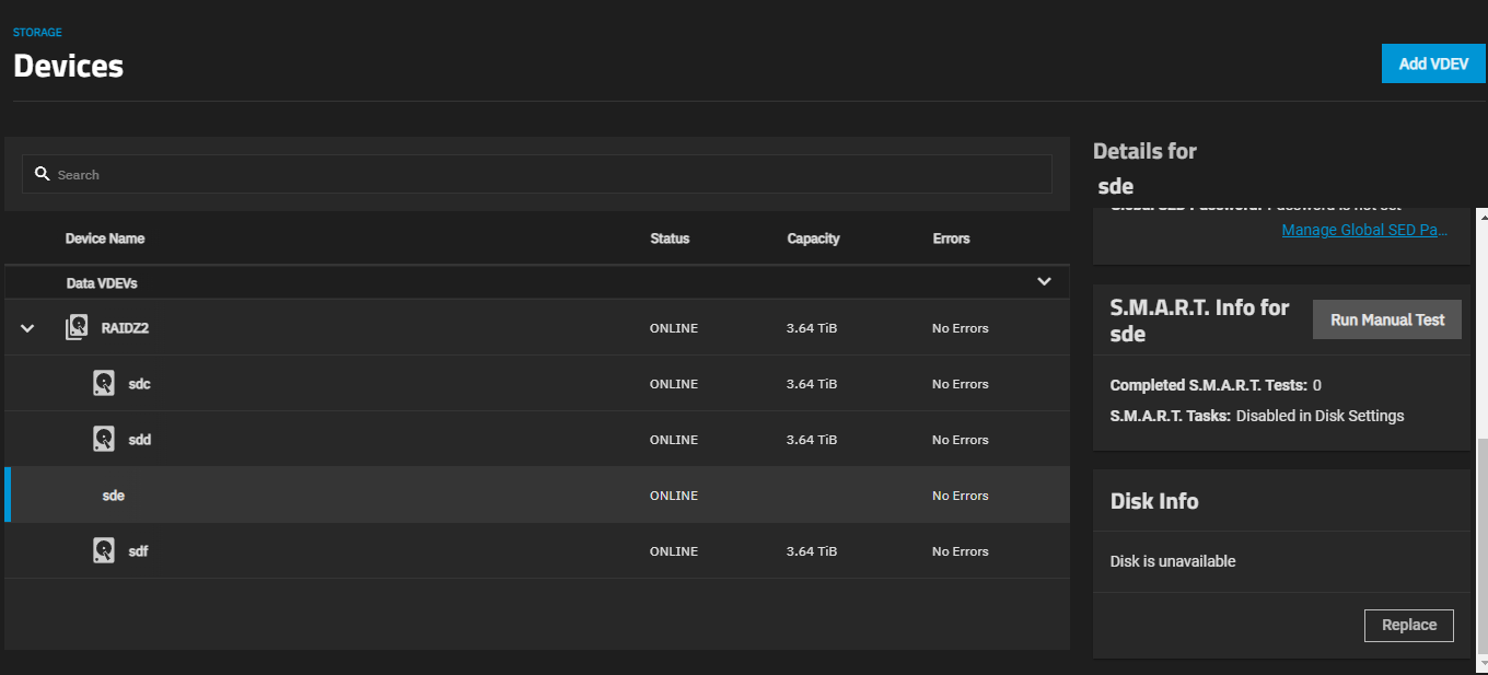

When I view the pool in the UI I see:
But if I check the status of the pool from the command line I see:

I'm not sure what this means. I've opened the case and replaced the SATA cables and reseated everything. Any idea of the best way to proceed. Could this have been caused by the accidental boot into Core?

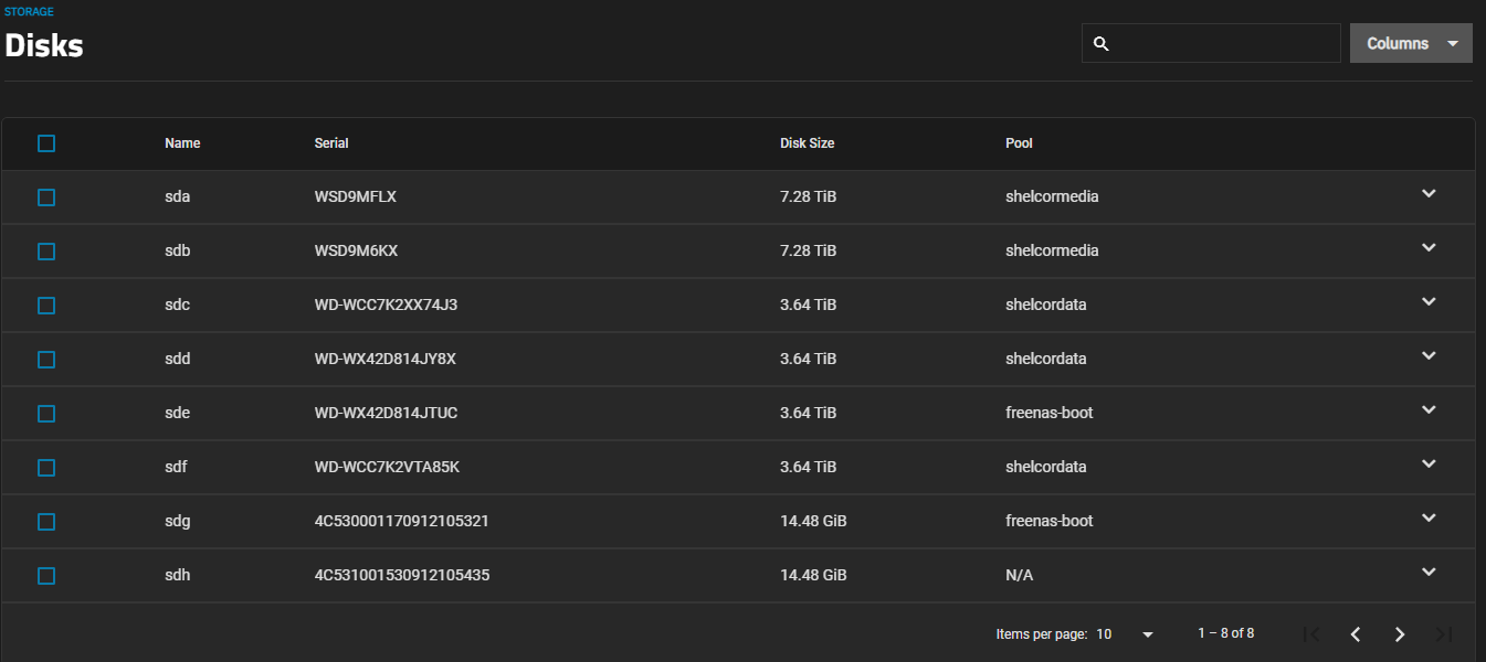

To further the weirdness of my setup, my system started as FreeNAS, years ago, and has followed a normal upgrade path over that time, leading to TrueNAS Core. My system was setup on with the boot pool on a USB drive which was later mirrored to another USB drive. So, I had two USB drives mirrored for my boot pool, 4 drives in raidz2 for my system dataset set and storage. I added two more drives (mirrored) earlier this week. However, here is what my system looks like today:
It looks like one of my 4TB drives from my raidz2 has been taken for my "freenas-boot" pool.

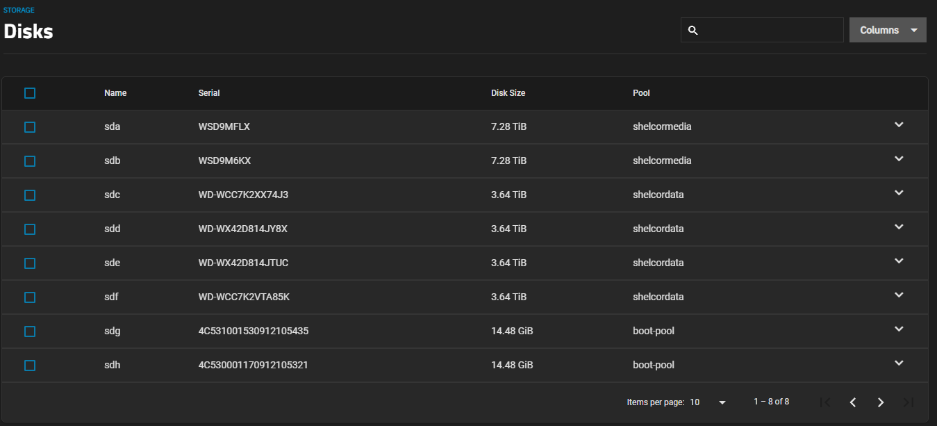

I decided to backup my configuration and reinstall Scale on my two USB drives. After that I reimported my config and it appears that everything is back to how it should be!
Easy peasy!
