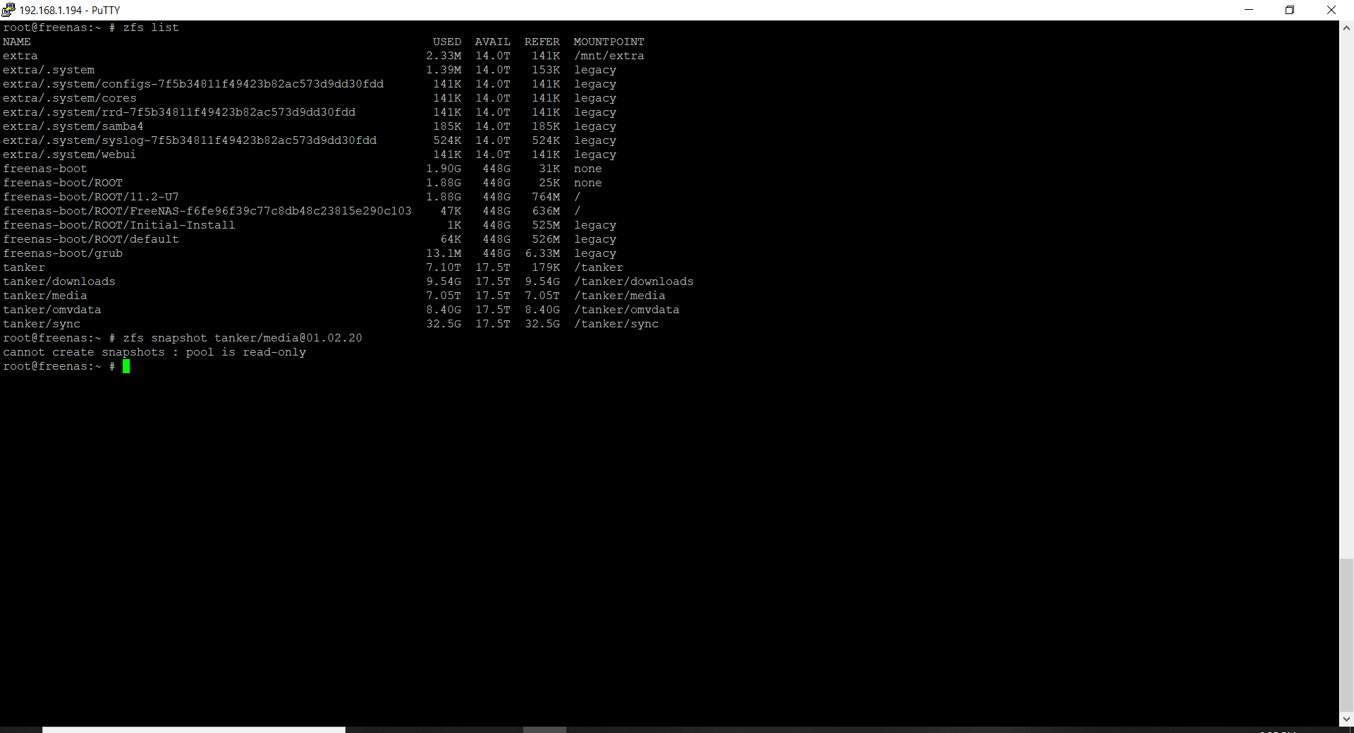

I have it imported the issue now is I can't make a snapshot to copy it to another pool because its in ready-only mode. How can I retrieve the data?
9,700
rsync
