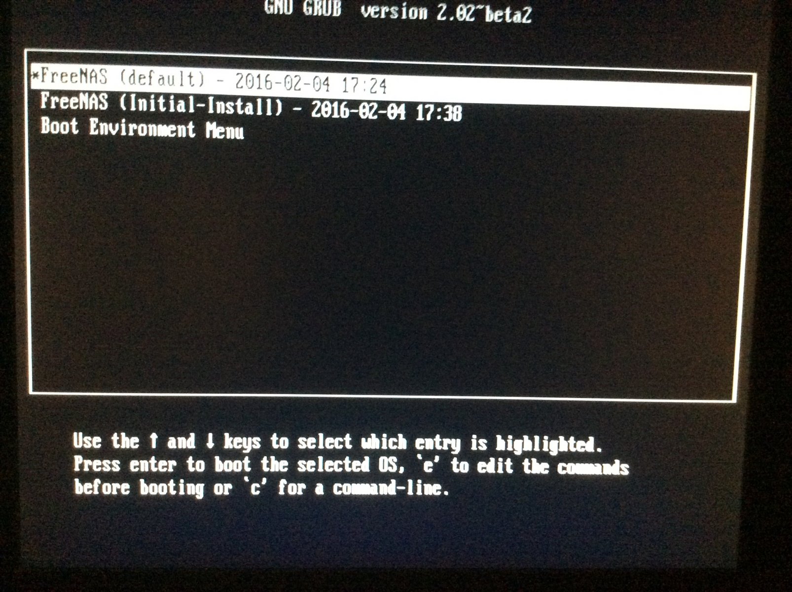

  • Reboot FreeNAS and when GRUB loads up, press "E" to edit

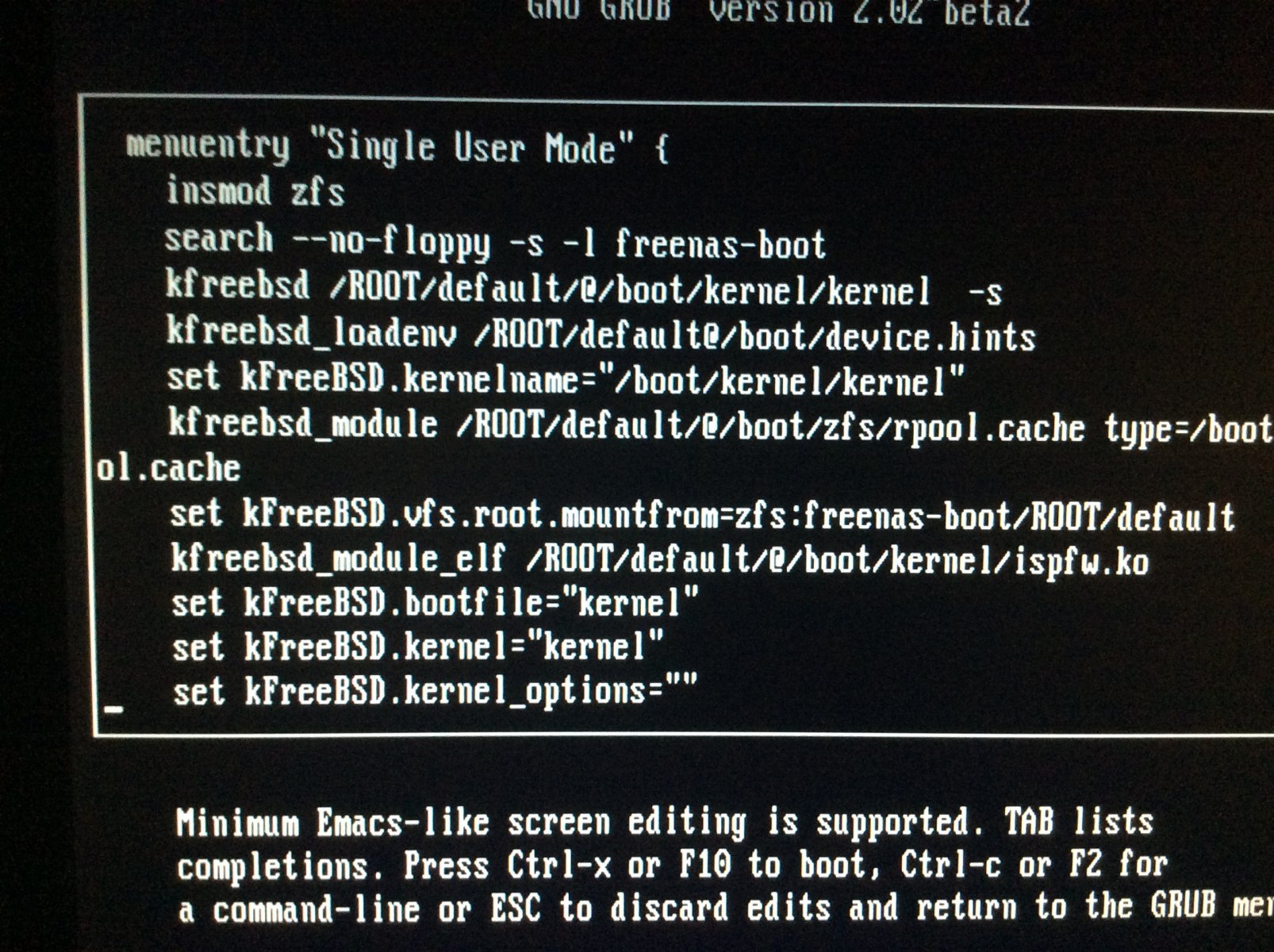

  • Scroll down to where the single user mode section starts. You want to add following two lines. Make sure you scroll down to the right section and make sure to follow the format of existing lines.
set kFreeBSD.vfs.zfs.recover=1
set kFreeBSD.vfs.zfs.debug=1
After second line, press Enter and once you are on new line, press Tab and it should exit the edit mode.
  • Once you are done editing, you can press Ctrl + X and it will reboot the system.

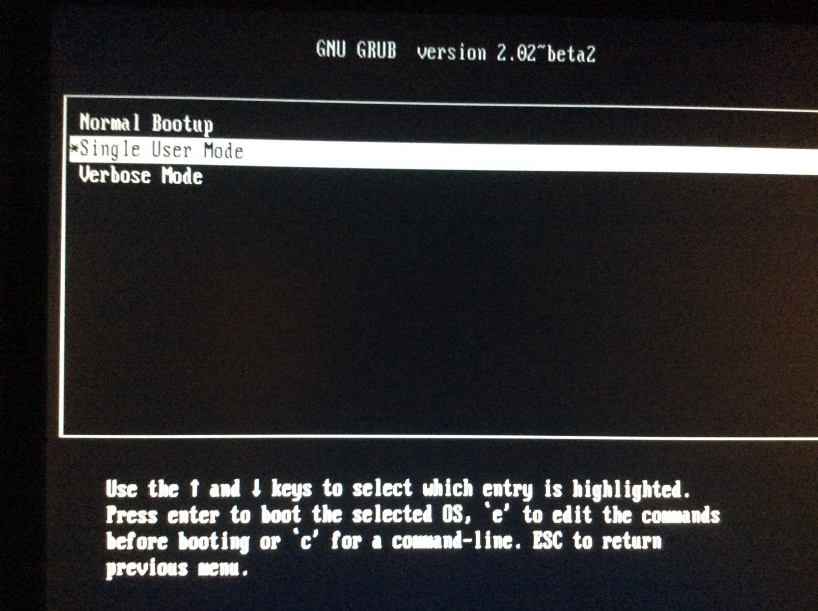

Once the GRUB menu loads up again, be sure to select the single user mode that we edited previously.
