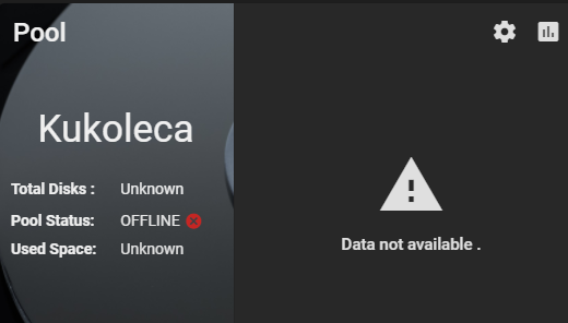

Hello guys. I have a 6 drive RAIDZ-1 setup. Was replacing one drive (probably gptid/47af1739) and after booting, pool was OFFLINE/Data not available.
A ssh-ed into my server and it shows that gptid/4766b1cd is offline ?!

How can I get it online and import the pool? Any help? Much appreciated. Thank you all in advance.
Regards, Miroslav.
