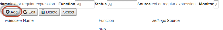

Hi, I'm new to FreeNas but have used Zineminder on Rockstor before without any problems. I've installed FreeNAS 11.2 stable just now incl. Zoneminder.
I'm getting to the GUI of Zoneminder itself, BUT if I hit the "ADD" button nothing happens - no window pops-up in order to configure your cam (IP, User, PW,...) - can someone help me?
I've also looked up for the above mentioned "my.cnf" file which is not stored under /usr/local/?

Hawkevilcat
Jun 3, 2018
Here is a reason why if someone can look into it. It is not just that the add camera button does not work. The entire layout of the page is not right.
In this attachment you can see that there are multiple errors from javascript files.
Digging a little deeper by viewing one of these javascript files then you will see that the file is not a javascript file, but an html file.
I have been hoping for this plugin to come for a long time now and I would really like to get this working,
AxAn
Mar 18, 2017
8
That's the same thing I found. I reported the bug, and somewhat of a fix, here: https://redmine.ixsystems.com/issues/66187
