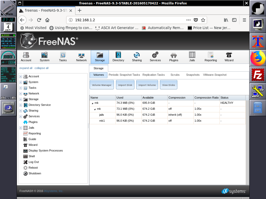

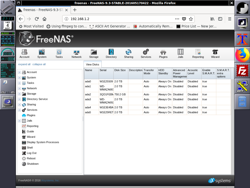

pagetelegram
Sep 3, 2019
8
Using Supermicro Xeon server slate, 6 sata connections. Using plop CD to boot the USB that contains the FreeNAS.
Here are some screenshots:

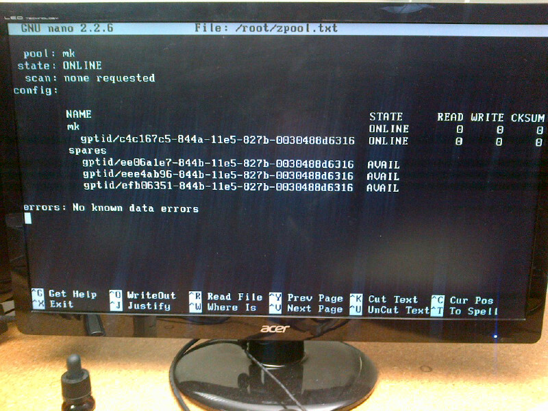

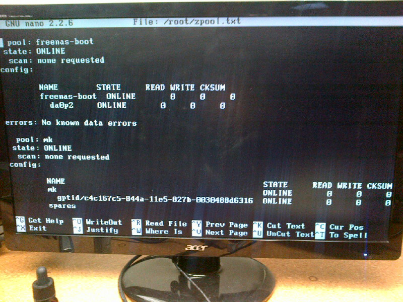

pagetelegram
Sep 3, 2019
8
zpools:

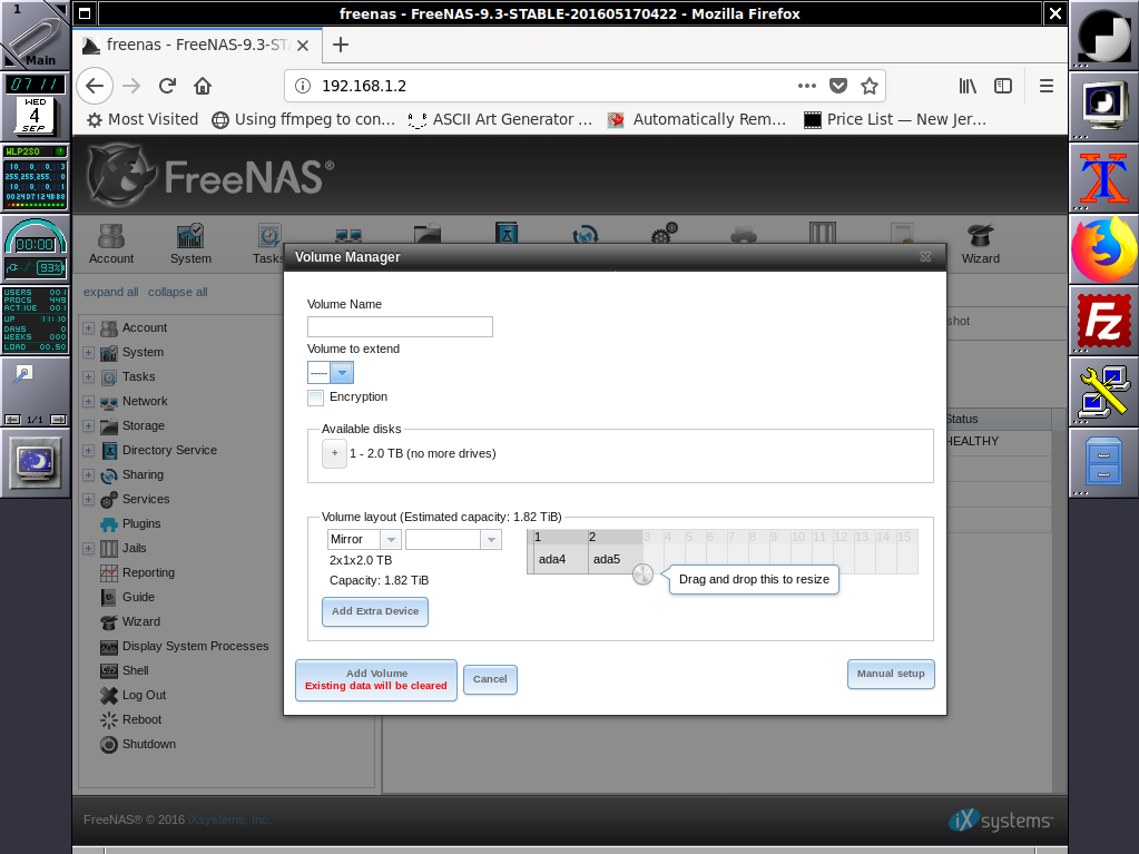

Did you use the volume manager when you attempted the pool import?
garm
Aug 19, 2017
1,556
Okey.. you definitely do not have a four drive pool. You have a single drive pool with three spares.
My money is on you lost your data. Maybe someone will come along and suggest a recovery route.

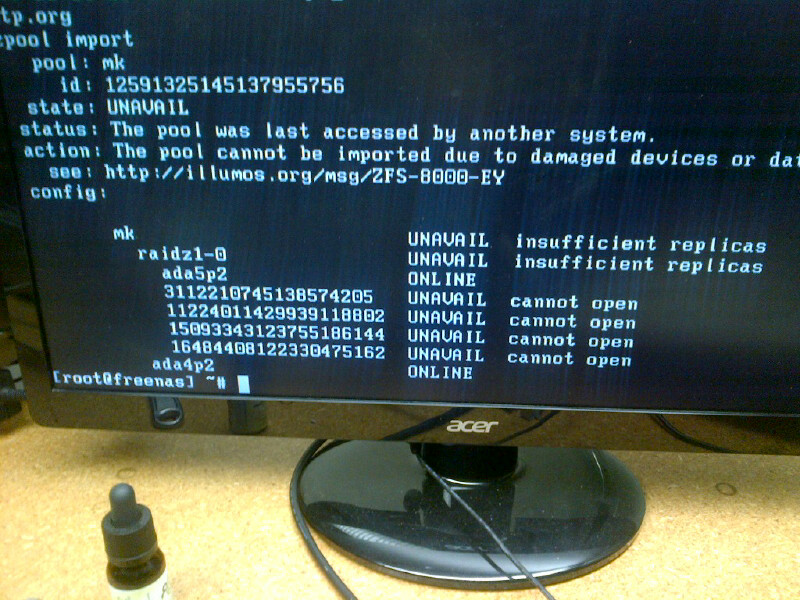

Just for good measure, what does zpool import say?
pagetelegram
Sep 3, 2019
8
So is it possible I had encryption? Too long ago to recall.
garm
Aug 19, 2017
1,556
No it’s not encrypted, you should just have followed the manual for pool import instead of nuking the drives. zpool import sees your remaining drives and want you to supply the missing drives, those you used to create a new pool

15,504
It's amazing the ways people come up with to destroy their data. And how little attention they pay to the message that says all data will be destroyed, until after it's already happened.
@pagetelegram, unfortunately, the data on this pool is lost, and it's through a series of very poor decisions:
  • This was set up as a RAIDZ1 pool, which only provides one disk's worth of redundancy
  • Rather than the six-disk RAIDZ1 pool that was intended, it was set up as a five-disk RAIDZ1. Apparently recognizing this error, they added the sixth disk (ada4) to the pool. But that disk was never part of the RAID set, meaning that it was always critical--failure of that disk alone at any time would have resulted in loss of the pool. It was also apparently added from the CLI rather than the GUI.
  • Bad as all that was, it wasn't enough to result in data loss--that didn't happen until you created a new pool on four of the six disks, and in a truly bizarre configuration. When you did that, you apparently ignored the bold red text here:
    Do I know that you did this rather than someone else? No, but it sounds like it. You can check for yourself by looking at the output of zpool history mk--that will tell you when the pool was created, and by extension, who did it.
