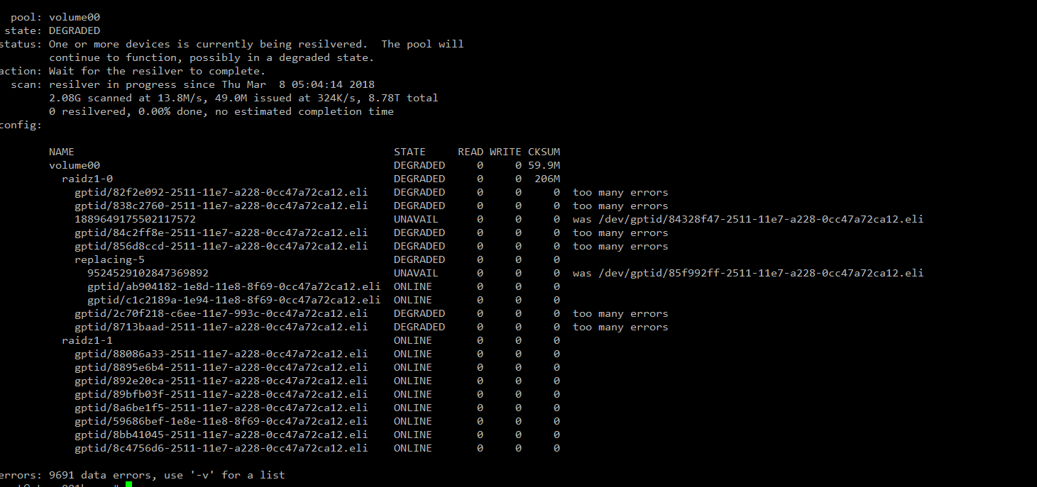

Recently I had 1 drive dead in my pool. In addition to dead drive - wrong drive had been pulled from live storage. Then good drive had been pushed back and bad drive replaced.
Although - pool now can't reconstruct itself.
But, luckily (hopefully) - it is a mirrored RAID10 and all those drives were in same part of mirror, so I suppose that data is intact. But zfs can't rebuild itself. May I manually recreate part of mirror? If yes - how?
Screenshot of current status attached.

It’s not a “RAID10”-like schema. You have two RAIDZ1 vdevs. One of which have 2 unavailable drives. A dual RAIDZ1 vdev pool is closer to something like RAID50. But it’s best to not use the “RAID” terminology altogether.
You are in a very bad situation and hopefully someone will be able to guide you. I will not however due to the risk of data loss with every action from now on.
Also, when you have sorted this out you should consider another topography. Running RAIDZ1 is not adequate redundancy.

But if its a raid 50 - this mean that there 2 "big volumes" , where system should be able to live if one of half is dead, no ?
I kinda said good bye to data already, we have a backup of all of this ... but restoring procedure could be very long, thus trying to save this if possible.
No, it's like a RAID 50, not a RAID 51, so if you lose one part the whole volume is lost.
You are losing sectors on the drives (that's why it's very slow) faster than you can rebuild the data so to me this pool is lost, be ready to restore from backup. And before restoring I recommend you to destroy and rebuild the pool as two RAID-Z2 vdevs of 8 drives instead of RAID-Z1.
Also, do you have SMART tests correctly configured?
And what's the output of smartctl -a /dev/adaX for each drive (please use the code tags to make it readable)?

warpik
Mar 2, 2018
17
Couple of drives still testing (after 24 hours =\ )
But it looks like only single drive in warning with large reallocated sectors count - and those that not completed yet - i believe everything ok.
warpik
Mar 2, 2018
17
Hmm, what is benefit of making 2 RAID-Z2 vdevs ? To be able sustainability of 4 drive in total (2 maximum in each of Vdevs?), right ?
Bidule0hm
Server Electronics Sorcerer
Aug 5, 2013
3,710
Ok, so:
da0 test still in progress
da1 test still in progress
da2 test still in progress
da3 test still in progress
da4 OK
da5 test still in progress
da6 OK
da7 OK
da8 OK
da9 OK
da10 OK
da11 failing now, same as before
da12 OK
da13 OK
da14 test still in progress
da15 test still in progress
I can't say anything for the drives who are still in progress.
Yes, it would have avoided your situation where a second failing drive create corruption while you're resilvering a first failed drive, we recommend RAID-Z2 over RAID-Z1 exactly for this reason.
But I can guess this drive is failing since a few weeks if not months and the real problem is that you didn't setup the SMART tests and/or the FreeNAS alerts correctly so you didn't receive the warning emails you should have received.
warpik
Mar 2, 2018
17
