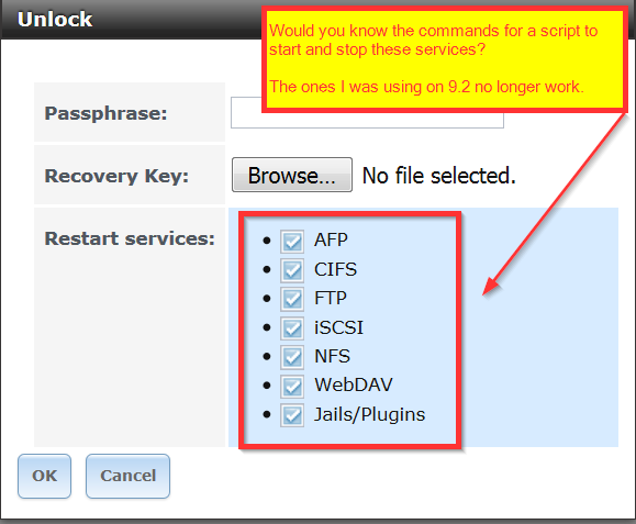

Hi, Dusan, I'm hoping you see this.
Your help with the above stop start lines have been working flawlessly for two years now, many thanks, but I just upgraded to 9.3.1 from 9.2 and they no longer work in 9.3.1. My search keeps bringing me back to my own post. Would you know what the new script lines I should use would be?
One last question if you don't mind, what would be the right way to encrypt and unmount a volume: zfs unmount (Volume name) I know it works but I don't know if it's the right way to do it via a script.

If you're reading this and you know I came up with this to restart CIFS after auto decryption for as above the F/N 9.2 version doesn't work with 9.3.
It works but currently I have disabled until I can get some confirmation from someone who knows.
# 9.3.1 service restart for auto decrypted volumes.
# service samba_server stop
# service ix-pre-samba restart
# service samba_server start
# service ix-post-samba restart
# service collectd restart
