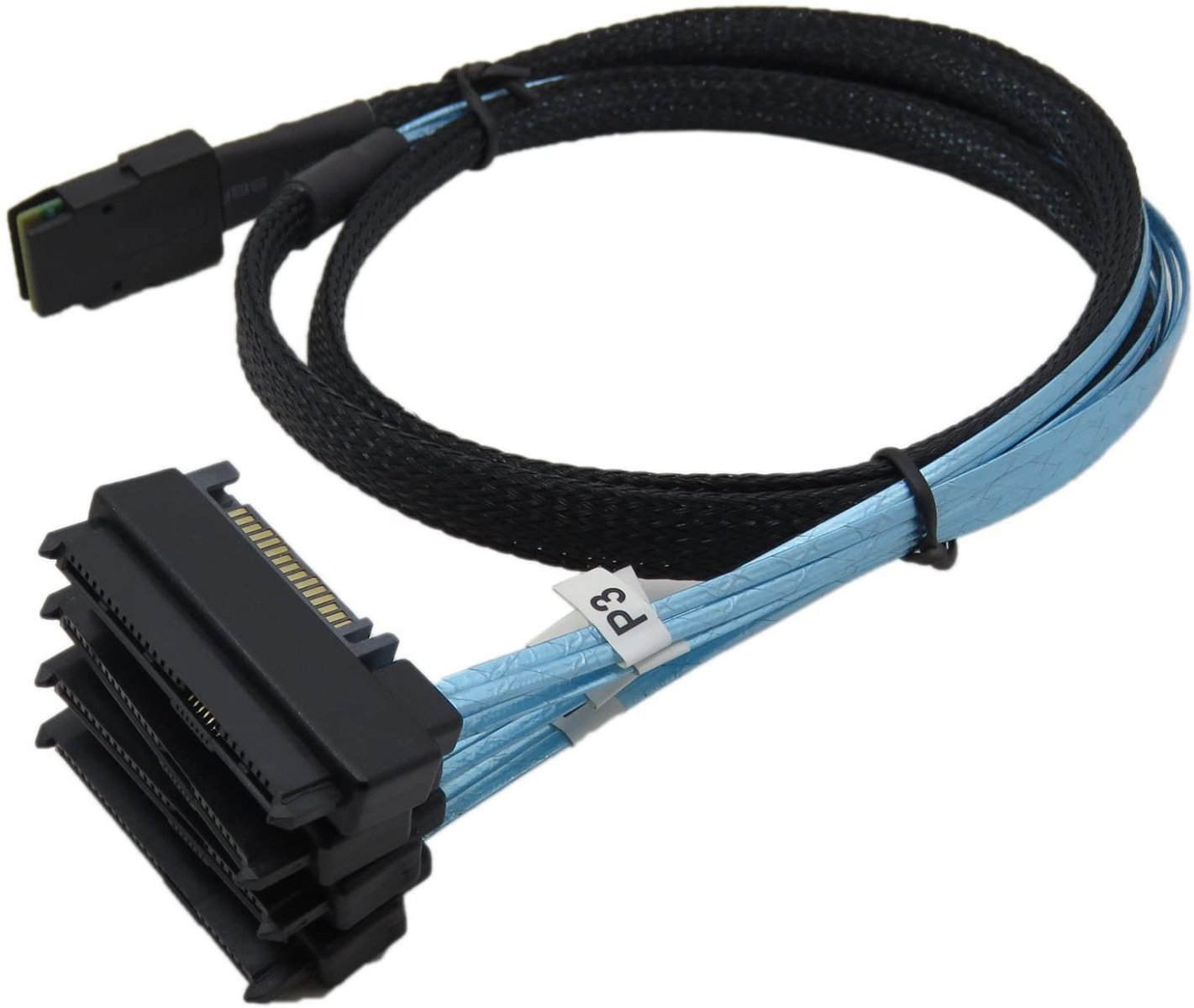

I have seen connectors with data and power combined, but they have always had a place to insert a separate power cable right into the back of the bigger combined contact.
Like so:
Do yours have something similar? It's difficult to see in the picture you provided.
You were indeed correct, the cables do have the SATA power connector in the location shown in your photo... but... they don't work anyway :eek:
Was spending some more time on the build last night... I used the SAS cables that came with the motherboard to connect SAS drives to the onboard controller, and I used these 10Gtek cables to connect other SAS drives to the PCIe SAS controller: https://www.amazon.com.au/gp/product/B08B1NWP67/ref=ppx_yo_dt_b_asin_image_o01_s00?ie=UTF8&psc=1
The drives connected to the 10Gtek cables showed up fine, but not the ones connected to the cables that came with the motherboard (Foxconn I believe). I then connected the 10Gtek cables to the onboard SAS controller and the drives showed up fine. So that narrows it down to a cable issue I guess.
Not sure why the ones included with the motherboard don't work. I can buy more 10Gtek ones I guess, but then need to somehow work out how I am going to find another 8 x molex connectors.

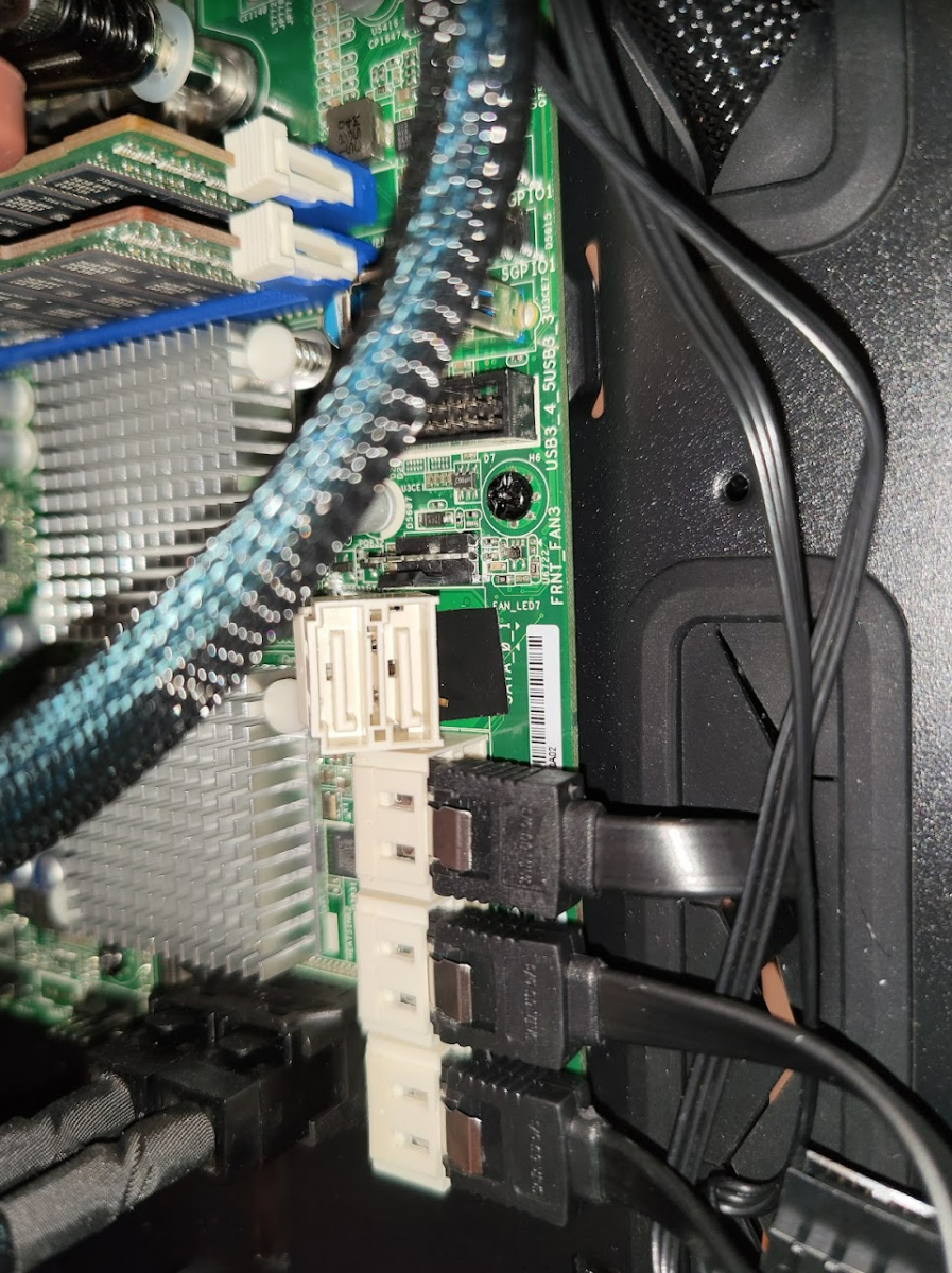

So got the build finished... couple of photos attached. In the cable management excitement managed to lift up one of the SATA ports ffs :eek:
I gave TrueNAS Scale a red hot go, but was just too buggy and kept hitting issues. Running TrueNAS Core on top of Proxmox now.
I think you did a better job of cable management than me
Keen to hear how your drive temps are going. The bottom two drives closest to the power supply run 8-10 deg hotter for me (compared to the other 14). I added a fan where you have the 2.5 SSD, but that didn’t help significantly.
I also have a fan directed at my HBAs and network card… potentially (/probably) unnecessary.
Nice to see someone else running a lot of drives… makes me feel better

At the moment for the 12 SAS drives, the temps range from 35 to 41 degrees celsius. I have another 4 SATA drives right at the bottom of the case that you may have spotted in the second photo, but I gave up trying to connect them for the time being after getting a bit frustrated with the cable management, and having difficulties with the SATA power connectors being long enough to reach all the drives. I'll probably revisit that when I need the additional space.
I originally moved one of the front fans down lower, so that those bottom SATA drives would get airflow. I've left it where it is for the time being anyway.
