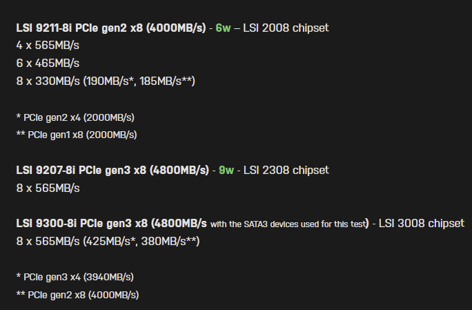

Also, I found an interesting comparison of a hefty slew of HBA controllers' throughputs during "parity check" on an neighbouring forum - attaching the parts relevant to this discussion down below (note - the post is from 2015, but seems relevant for these SAS chipsets at least).
I not exactly sure what kind of workload this particular test runs (the details of tests and test platform itself are pretty skimpy), but it seems to me like a combination of sequential reads + CPU parity calculation.
I am surprised to see such a drop in speeds with the increase in lane occupation on these SAS controllers - aren't all lanes supposed to get full speed (which is 6 Gbps ~= 700 MB/s)? Is this related to controller itself or SAS (full-duplex) vs SATA (half-duplex) protocol differences?
One other interesting thing to note is the impact of DMI (the Intel bus between PCH/SouthBridge and CPU) generation (1.0 vs 2.0 vs 3.0) - in particular, DMI 2.0 has a max bandwidth of 2 GiB but seems like 4 drives connected to it are capped at 270 MB/s (which a little more than half of the nominal). Not sure if that test is relevant for SATA-2 only perhaps and four (4) SATA-3 drives should get the full bandwidth at all times when connected to that bus.
No. As wonderful as it would be if everything went full speed all the time, what's actually happening with an LSI RAID controller is that you have a MIPS-flavored Raspberry PI-like device attached to some HDD ports. It communicates with the device driver on the host platform, moving data back and forth. When the host says "Read block 2414892 of virtual disk 2", it does some quick computation to determine which physical HDD and LBA that is, issues a read command, reads the data, and then feeds that to the host's driver. If there was an error, it attempts to read the data from the RAID redundancy. Maybe replace a drive if it's failed. Etc.
I've explained LSI RAID in this manner so that you can see that there is no ACTUAL direct path between the host and the HDD ports. The host cannot talk to the disks DIRECTLY.
HBA IT mode uses a different firmware, so that communications is parroted through the LSI's CPU. The host driver says "I want to read LBA 231324 of physical disk 5" to the HBA CPU, then the HBA CPU issues that actual read command down the correct SAS lane, the drive responds with the data (or error), and the HBA CPU parrots that back to the host.
This effectively nullifies the fancy RAID features that the LSI CPU could be doing, but still allows it to do stuff like SAS management. This is why you can hook 24 HDD's to an LSI 9211-8i via an SAS expander.
This design comes at the cost of the LSI CPU "touching" every I/O back and forth to the actual drives. Therefore, there is an ultimate limit for performance -- whatever point the LSI CPU tops out at.
Now, LSI did make sure that the 2008 could handle reasonable common workloads such as 8 directly attached hard drives, but it has been known for a long time that the 2008 is not actually capable of shoveling around the 48Gbps that might potentially be required if you hooked up 100 HDD's on SAS expanders. Or 8 SSD's speaking at full 6Gbps, but that's more of a recent development with the advent of full-speed SATA SSD's.

This makes perfect sense to me - I was wondering why an HBA in IT mode would have its CPU involved in block translations (and, by extension, in each disk I/O operation).
