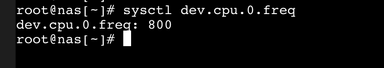

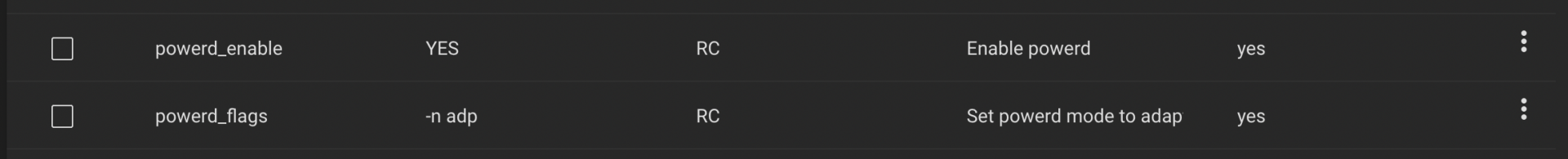

Hinterwaeldler
Sep 13, 2021
11
Have you tried to set powerd to throttle your cpu more aggressively by using the adp mode?
I have set two rc.conf tunables for this:
powerd_enable=YES
powerd_flags="-n adp"
Now my cpu idles at 800mhz and scales up only if I have load
powerd_enable=YES
great, I didn't know about this.
Unfortunately, in terms of power consumption this doesn't make a change in my situation. But I still need to double check.
Furthermore I replaced the 850w power supply with a 450w one and this reduced the power consumption in total by ~6 Watts - most likely due to a better efficiency.
Replacing the HBA PCIe card by the onboard SAS Controller gave me an impressive reduction of another 13 watts.
So I am around 109 Watts for the entire system. This looks quite promising already.
