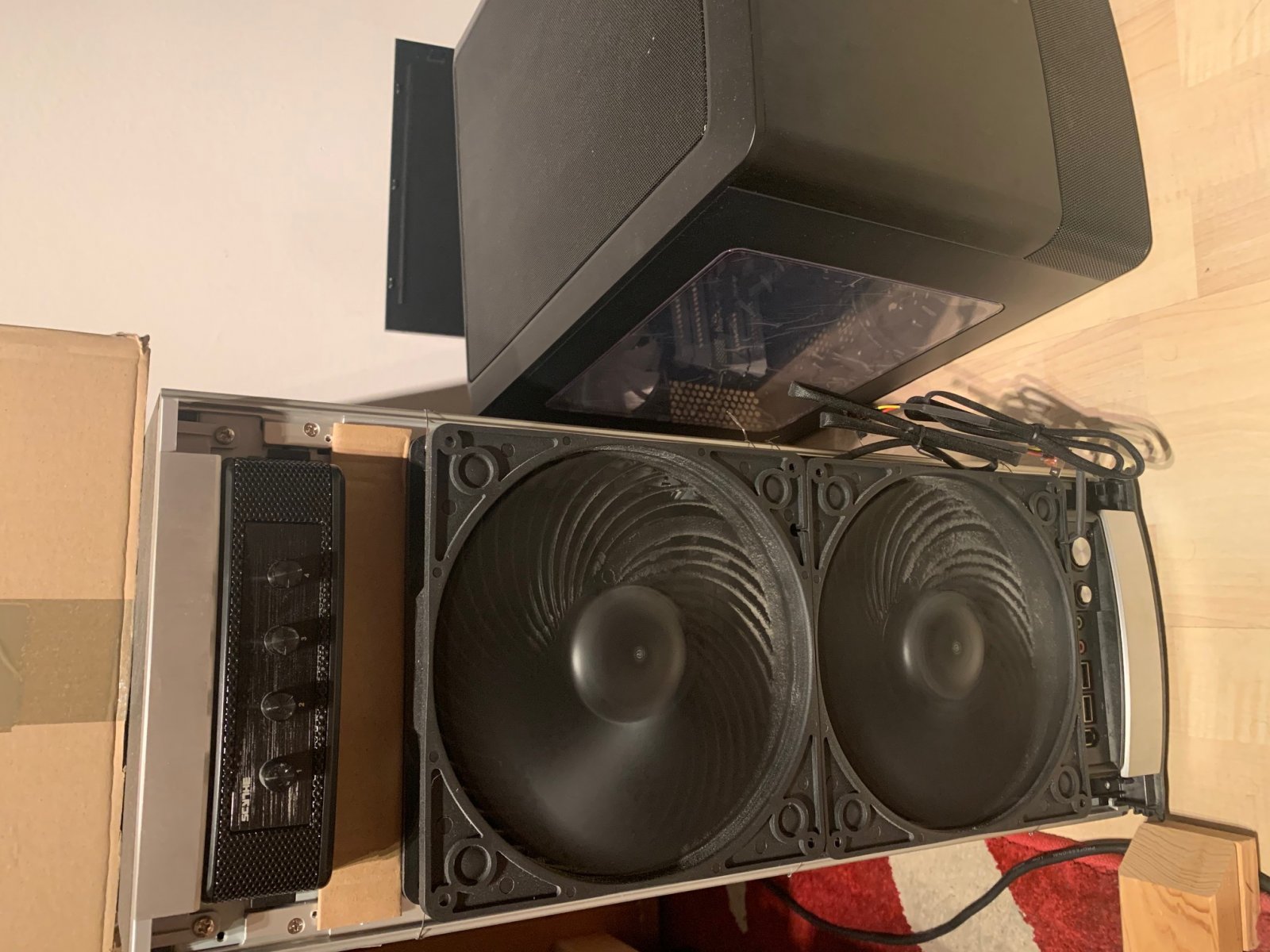

my 2 cents:
go with big ram
+ you can upgrade
+ saves you power
- more expensive
i have this node case as well and i really hate it!
it is equipped with 7 discs and temps are going beyond 40 °C during replication task
(5 case fans!!!)
while on the motherboard side you have way too much space, the hard disc side is very tight. most of the time the side cover from HDD section is open :-(
so my recommendation is to go with those sharkoon vibe fixers and take a case with enough 5,25 slots, put some silverstone 180mm air penetrators in front and be happy with low temps and low noise
case with the big fans:
it seem this brand is out of business
BTW: in case someone has a recommendation for me for a dust filter, i would appreciate!

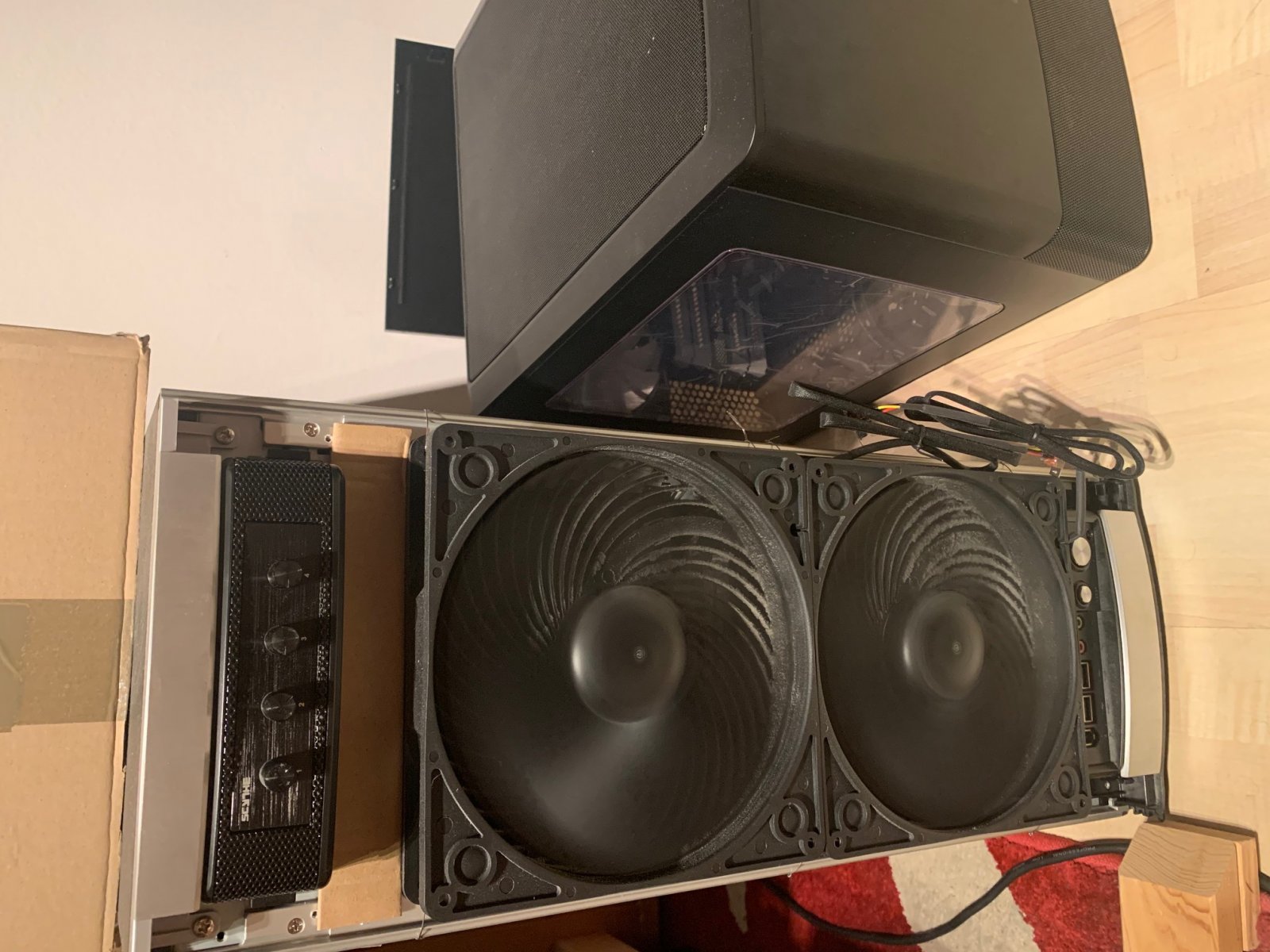

(5 case fans!!!)
so my recommendation is to go with those sharkoon vibe fixers and take a case with enough 5,25 slots, put some silverstone 180mm air penetrators in front and be happy with low temps and low noise View attachment 36248
He is talking about box fans, but the same principal could be applied to your computer fan system.
