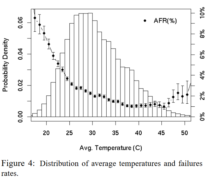

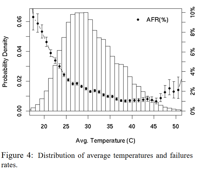

I think both of these statements are false. If you look at the study, and specifically Figure 4 which I have reproduced below, there is in fact a clear negative correlation between temperature and AFR within the temperature range they had data on. Also of note is the sharp rise in AFR above 45C, which to me at least looks like a stark warning to anyone considering running their drives at elevated temperatures.
Source: https://static.googleusercontent.com/media/research.google.com/en//archive/disk_failures.pdf
Thanks for finding the full article.
Here is the text describing the figure:
We first look at the correlation between average temperature during the observation period and failure. Figure 4 shows the distribution of drives with average temperature in increments of one degree and the corresponding annualized failure rates. The figure shows that failures do not increase when the average temperature increases. In fact, there is a clear trend showing that lower temperatures are associated with higher failure rates. Only at very high temperatures is there a slight reversal of this trend.
I believe that the * is the AFR (Average Failure Rate, it is the histograph over the bar chart ) So it looks like you should make sure that your drives aren't too cool, because below 35C the failure rate is largest, and only at temperatures above 45C do you see the graph start to got up. Between 36 and 45 look great. In fact, it looks like 46C shows the lowest AFR.
But this is the opposite of what the graph shows, and the study concludes. The lowest failure rate happens at 46C ( 114.8F ), which is considered extremely hot for a drive. Most of the fan control scripts kick in to overdrive at 40C. The curve only really takes off at 51C ( 123.8F ). The graph really shows high failure rates climbing for drives that are relatively cool 30C ( 86F ) and below. Even their conclusion states this.
One of our key findings has been the lack of a consistent pattern of higher failure rates for higher temperature drives or for those drives at higher utilization levels. Such correlations have been repeatedly highlighted by previous studies, but we are unable to confirm them by observing our population. Although our data do not allow us to conclude that there is no such correlation, it provides strong evidence to suggest that other effects may be more prominent in affecting disk drive reliability in the context of a professionally managed data center deployment.
You said the study showed that heat wasn't a factor when it clearly does. Otherwise the AFR vs Temp in Figure 4 would be a constant horizontal line. I come from a different world where temperature ranges extend far beyond that of your typical data center environment, so I should have been clearer when I used the expression 'elevated temperatures'. What I meant by that was temperatures beyond 45C, say up to 65C which is what the WD Reds at least are rated for.
