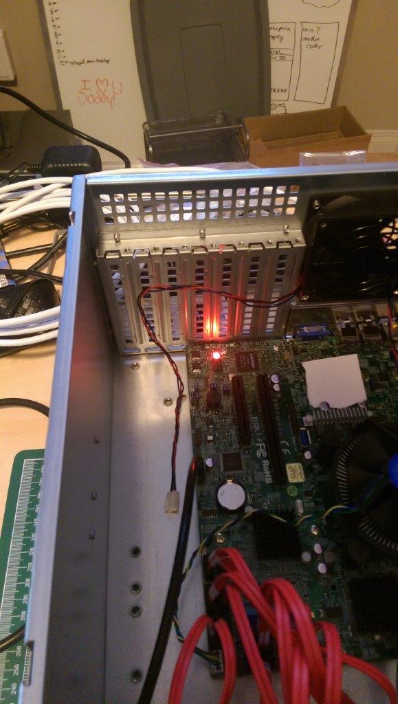

I just noticed something... There is a Power LED on the motherboard. The manual states it has 3 colors.
Green = System Power on (Power Normal)
Yellow = Standby Power Active (System Off)
Red = System Power has a problem (Power Failure)
Now mine turns green when it is ON. However when it is off it is Red and not Yellow. According to the descriptions above it sounds like it should be Yellow when the power is off. This may be the problem with my board in that it always thinks the power has failed.
Anyhow I was hoping that you guys could check the LED on your boards when it is turned off to see if it is yellow or red. I have attached a picture with the location.
thanks
thanks
On my board:
Machine OFF:
  • LE3: Green
  • LE5: Green (blinking)
  • LE6: Red
  • LEDS2: OFF
Machine ON:
  • LE3: Green
  • LE6: Green
  • LEDS2: Green (blinking)
Theodoros
Nov 16, 2014
15
Thanks. I guess red is normal then when it is off.

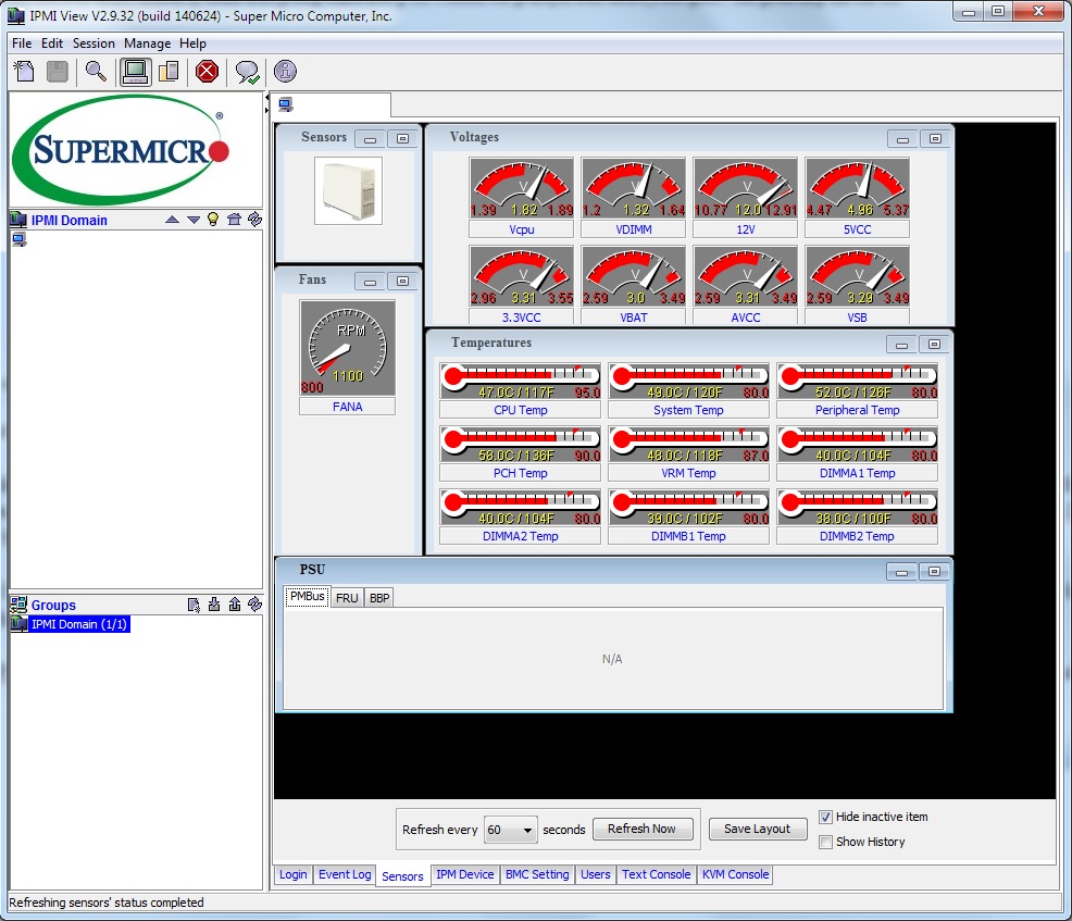

Since we're talking about PSUs...
The only thing that I can't seem to monitor from the IPMI, is the PSU readings (PMBus, FRU, BBP = N/A)
From what I've read from another thread in this forum, these readings are probably only available from supermicro PSUs or server-graded PSU's.
Every power-up/shutdown either from IPMI or FreeNAS or the case, in any combination works as it should. Just send it back and get a new one. There is no point worrying about this board any more.
Yeah, you need a server PSU for those. Maybe a Supermicro Server PSU. Definitely something the provides data over the bus connector on the upper right (memory?) of the board. Enclosure management kind of stuff.
