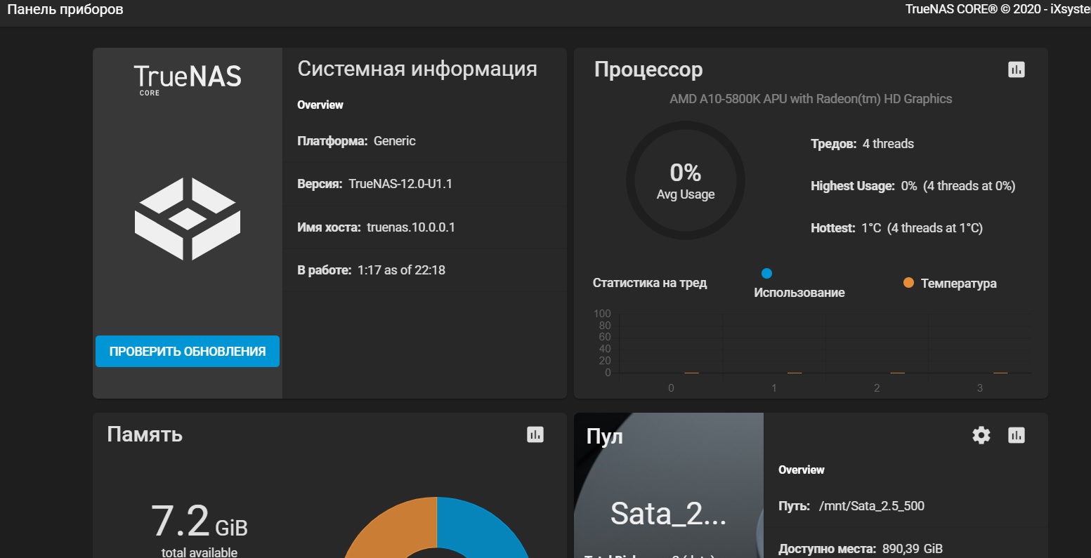

NiCOOLaS
Jan 28, 2021
I have the same problem with lowering the CPU temperature :confused:
AMD A10-5800K
root@truenas[~]# sysctl -a | grep temperature
dev.cpu.3.temperature: 10.7C
dev.cpu.2.temperature: 10.7C
dev.cpu.1.temperature: 10.7C

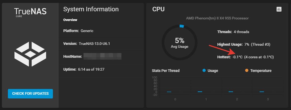

I have the same problem with my AMD Phenom(tm) II X4 955 Processor (3210.91-MHz K8-class CPU)
sysctl give the following data:
root@freenas[~]# sysctl -a | grep temperature
dev.cpu.3.temperature: -0.0C
dev.cpu.2.temperature: -0.0C
dev.cpu.1.temperature: -0.0C
dev.cpu.0.temperature: -0.0C
root@freenas[~]# sysctl -a | egrep "amdtemp"
amdtemp0: <AMD CPU On-Die Thermal Sensors> on hostb4
device amdtemp
dev.amdtemp.0.core0.sensor0: -0.0C
dev.amdtemp.0.sensor_offset: 0
dev.amdtemp.0.%parent: hostb4
dev.amdtemp.0.%pnpinfo:
dev.amdtemp.0.%location:
dev.amdtemp.0.%driver: amdtemp
dev.amdtemp.0.%desc: AMD CPU On-Die Thermal Sensors
dev.amdtemp.%parent:
I read a FreeBSD manual and found that amdtemp module support only 10h, 11h, 12h, 14h, 15h, 16h, and 17h Family processors
(FreeBSD 13.1 manual)
But there is a k8temp module which support K-8 Family.
I tried to install this module using pkg, ports, pkg files, but it doesn't work.
When I used FreeNas based on 10.2 FreeBSD - the temperature was dispayed correctly.
I think the support K-8, K-10 Processor Family were excluded from newer release
Have you any idea how to solve this porblem?
