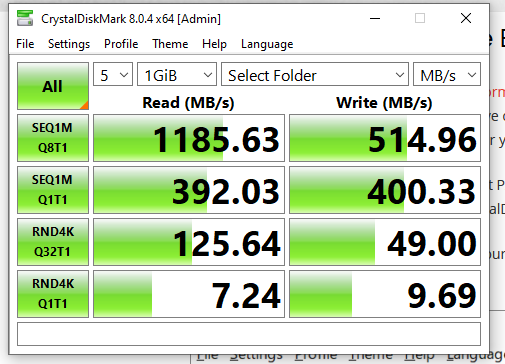

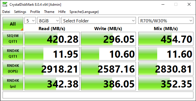

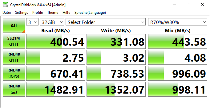

Yes I know, sadly I have no choice. I got the NIC running and its seeing 10 GBit.
Here are some results:
CrystalDiskMark default setting:
CrystalDiskMark Realworld setting (32 and 8 GiB):
