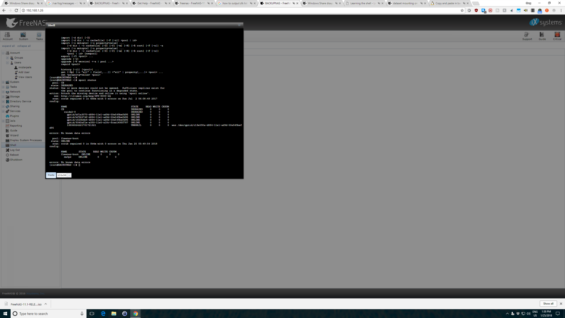

umm try following directions again, zfs list output please? And why do you have a disk that is failed? That needs immediate action, you shouldn't even let it get as far as fully failing like this.
misterpele
Dec 4, 2014
36
The drive has nothing to with the problem (the problem occurred before this). I will fix it later. It is able to go with 2 failed hard drives. I am trying to fix the other problem, then I will insert new hard drive and repool it.
And isn't that what was screenshotted? If not please tell me what else I need to do for you to get it.
My network sees the Windows share CB, but when logging into it, there are no directories (should be about 5 with 2-3 TB of data)

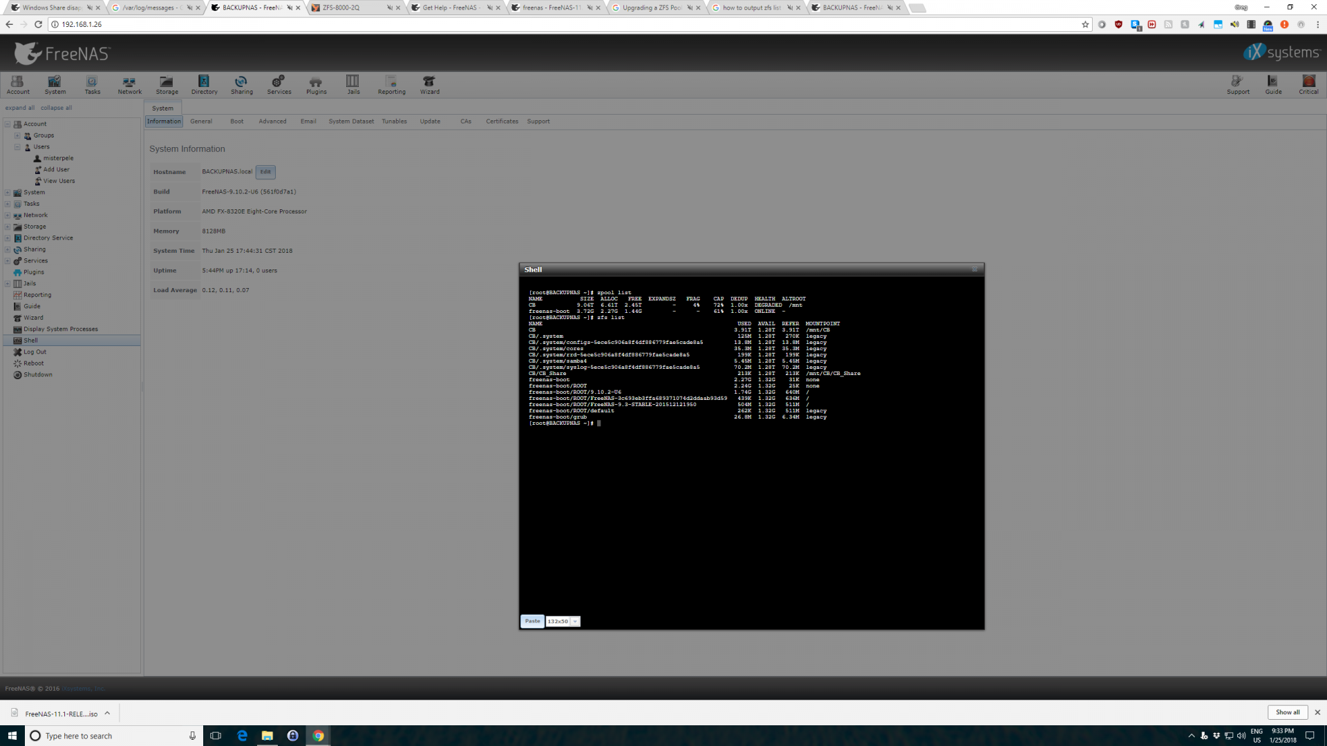

you typed the letters 'zpool status', I asked for the letters 'zfs list'. Can you see the difference? maybe just copy past the text into the terminal window.
misterpele
Dec 4, 2014
36
well I guess it would help if i actually did what you asked. Here it is...
SweetAndLow
Sweet'NASty
Nov 6, 2013
6,421
Perfect, now the answer is easy. You have mounted a dataset over a directory. All your data is in a directory and you created a dataset with the same name and path. I think if you umount /mnt/CB/CB_Share your data will appear. You should then delete that dataset if it's empty.
