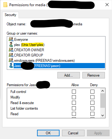

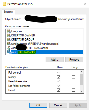

I added the plex user with the Windows security menu in explorer. I noticed some differences in what FreeNAS(left) does, and what Windows(Right) does:
Even after making this change plex is still unable to write to the backup sub-directory. The main difference I see is that for the media dataset the plex user is not part of the FREENAS domain(?), but instead listed a Unix User. Where when I manually added plex it is part of the FREENAS domain. What are the differences between the FREENAS\plex user and the Unix User\plex user? Is there a way I can give write permissions to the Unix User\plex on just the sub-directory of the backup dataset without performing a recursive ACL update from the FreeNAS GUI?
Your terminology isn't quite right here. I'm assuming that Plex has UID/GID 972. On the left image, the Plex user is part of the ACL; on the right, the Plex group is part of the ACL.
