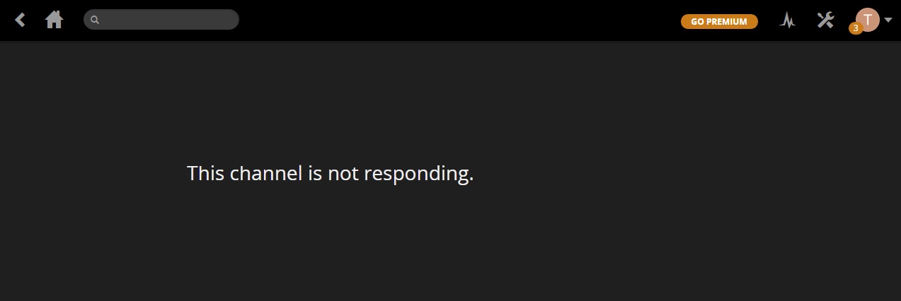

Hi there,
can you tell me where the folder for plugin is? I would like to add "letmewatchthis bundle"
thanks

/var/db/plexdata
Joshua Parker Ruehlig
Dec 5, 2011
5,949
i have no idea, i don't use plex personally.
