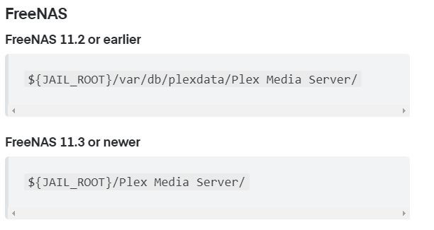

To find the plug-ins folder in the current version of FreeNAS, currently being FreeNAS-11.3-U3, you will have to just go into the jail section of your plex media share.
