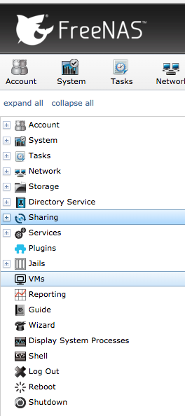

I use Docker and when looking for NAS system I was happy to see FreeNAS on youtube having Docker in Menu...
After weeks of completing HW, I succeed with installation of 11.1 and..... cannot find Docker in the menu...
Do I miss something???

Yes you unfortunately missed something, old YouTube videos really hurt new users like yourself. FreeNAS Corral was a major failure and died a very fast death, it is not supported.
The good thing is Dockers are expected to come back however I'm not sure when. For me it's a seeing is believing thing.

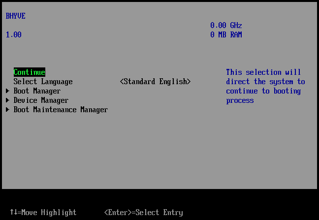

Yes, so I created ZVOL, VM, configured all devices including CD-ROM pointing to ISO image (rancheros.iso) and when starting VM and connecting to WEB VNC I see just UEFI Shell with information that CD-ROM is mounted but installation is not going (so no booting from CD-ROM was done) only I can put commands.....
Any clue why it is not booting from CD-ROM?

But did you check that rancher.iso will boot using bhyve's UEFI firmware? Did you exit UEFI to boot manager screens and to see if efi boot file exits in rancheros? FYI, the interaction between byhve UEFI firmware and many linux distros will need you to take action that's not described in current FreeNAS docmentation, see here: https://forums.freenas.org/index.php?threads/how-to-how-to-boot-linux-vms-using-uefi.54039/
Don't know if it is in 11.1 yet, but the "Nightlies" train now includes the use of a pre-built "rancheros" image via the UI and IIRC is uses grub-byve as the boot method, not UEFI.
If you want docker right now, and want to use the UI only to set things up and if rancheros fails to boot under UEFI, then I suggest using a debian9 net install for your linux VM and install docker & docker-compose in that with perhaps portainer. Choose the expert install option for debian and at the "install grub boot loader" step answer "yes" to "Force grub-efi installation to the removable media path" , this will ensure your linux VM boots correctly under bhyve's UEFI firmware.
This pointed me in the right direction, many thanks!!!
Still on the way to resolve but by putting simple exit command in UEFI Shell of the VM I could see the boot manager screen :) and select CD-ROM to boot from...
but it did not boot.... so I've switched to my CD-ROM mounted as BLK0: executed ls command and get "File not found", like CD-ROM would be empty, so no surprise that cannot boot from empty CD-ROM without ISO file...
So the current issue is that iso file is selected properly (and visible) when defining CD-ROM device, but for some reason not a part of CD-ROM when booting....

I would have expected you to navigate to the "Boot Maintenance manager" option and from there to use "boot from file" . If it fails to find the appropriate efi boot file on your iso, then it's not going to boot under UEFI. On a quick test with latest v.1.1.0 iso, I can't get it to boot using UEFI. I'm not able to test this in virtualbox or KVM/qemu at the moment to confirm this. They both use similar UEFI firmware to bhyve.
I understand your motivation to use docker in FreeNAS, but I think I'd want to know if performance is OK for my use before committing to it. It doesn't take long to create a minimal debian VM with docker, why get hung up on rancheros?
P.S. Trying to boot rancheros.iso in virtualbox confirms it does not boot under UEFI, it seems to be using isolinux and not grub.
