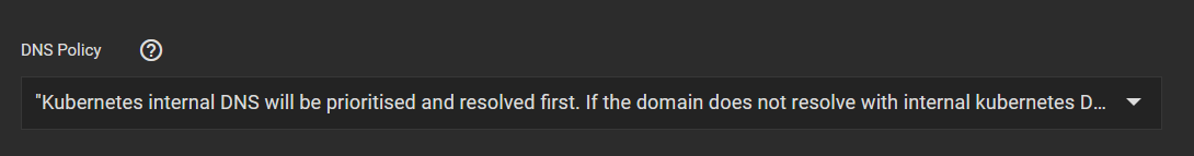

Ok, the answer to the question is: Yes, it is solved and it order to use the internal DNS, this must be specified per docker app in the configuration as Option 2 below DNS policy:
Then, the correct host name needs to be figured out according to https://truecharts.org/docs/manual/SCALE Apps/Quick-Start Guides/linking-apps/
My challenge was to understand what $APP refers to. In my case it turned out to be "ix-chart".
Questions answered. Thanks!
