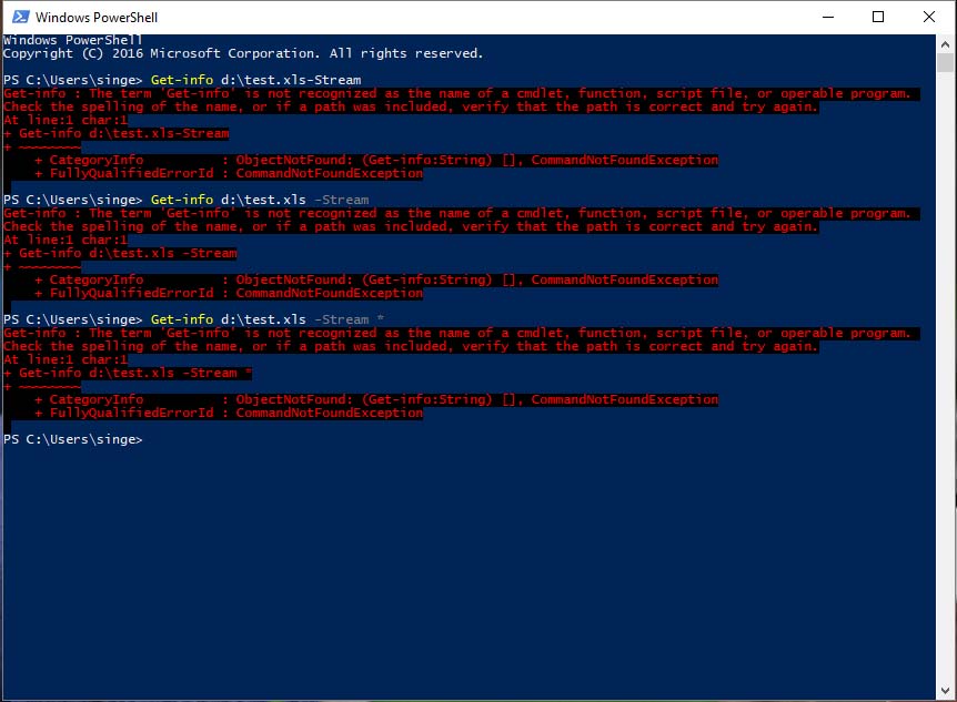

" Access Denied" can sometimes be a generic error message in samba. Try checking for presence of an ADS on one of the files that fails to copy. You can do this on Windows 10 by running the powershell command Get-Info <filename> -Stream *. I.e. Get-Info c:\User\me\Desktop\foo.avi -Stream *
Post output here enclosed in [ code ] tags.
Get-info gave me an error. Tried renaming and different syntax options but maybe i still got it wrong
