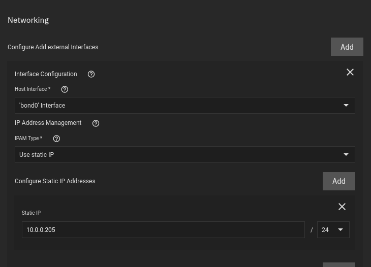

I've done this already, I don't understand what's hacky about the IP assignment, can you please elaborate? I spent a few hours reading into kubernetes and docker last night and it seems like these are all kubernetes cubes with their own local virtual network adapter (IE they can all speak to one another with some dynamically assigned address local to the system), but you can also set up an external interface which is just a bridge adapter into my LAN which is exactly what I want so I did that.

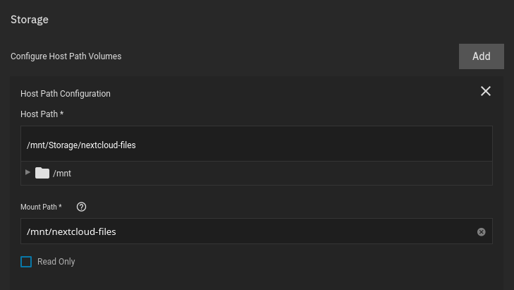

Can you elaborate on this too? For example, on nextcloud I attached ZFS datasets within the container like this:
This is where my old nextcloud files are located. When I turn on the container, I can access this path without issue. I can still take periodic snapshots of this ZFS dataset so I'm not sure where the data loss part comes in.

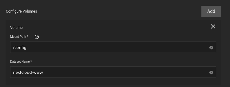

Additionally, I learned pretty quickly how the whole thing basically reinstalls itself every time it's booted and stopped, this is where I read into Persistent Volume Claims. I think that's what this is here:
At least in testing it seems to be. This basically maps that directory within the container (/config) to a dataset located in my pool, which is all dynamically handled by kubernetes it seems:
