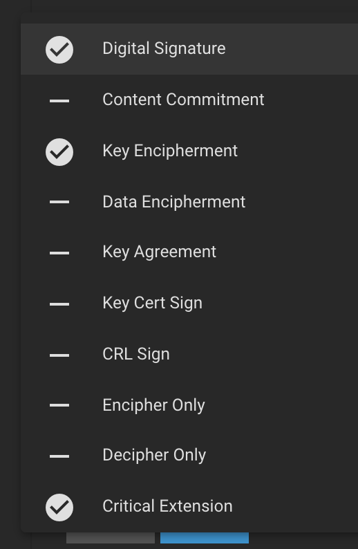

I followed these directions and it wasn't as clear as it could be. The only profiles available are OpenVPN Client and OpenVPN Server. I assume you want server? Also, what key usage config flags do we want? The defaults are as shown at the bottom.
When submitting, it throws this error for me:

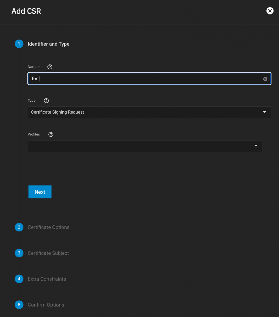

I figured out the disparity. In the directions, make sure to mention *no* profiles are selected:
ornias
Mar 6, 2020
1,458
I did follow the directions. I can screen cap if you really want it. Perhaps some assumptions are being made in the directions?
No, no assumptions are made.
Key config flags are not a part of the guide and the guide clearly states:
"If you are not sure, the defaults are alsmost always "alright", because most of what you enter here is completely ignored by Letsencrypt."
