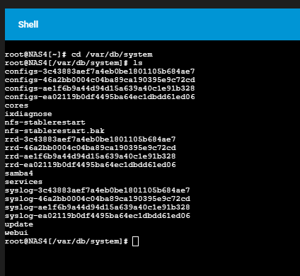

Go to the shell and run cd /var/db/system, then ls and screen copy the result here, like this:
needshelp
Dec 13, 2020
18
ok

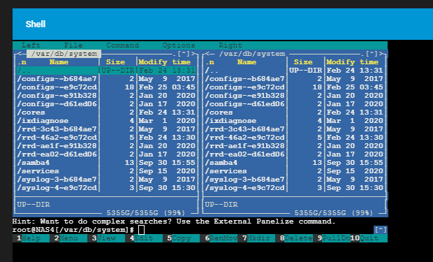

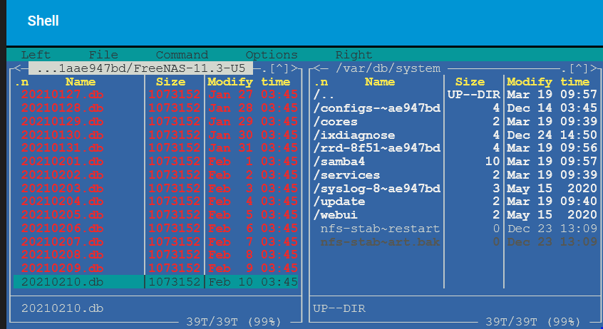

OK - now type mc to open midnight commander and post the output:
needshelp
Dec 13, 2020
18

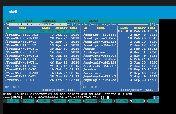

OK, arrow key down to select the configs file - one line down for you - hit return and post output:
needshelp
Dec 13, 2020
18

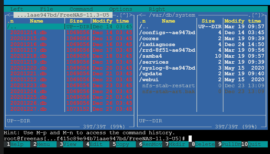

OK - here you can see that you do have an autosaved config folder created at 03h45 on Feb 10 - that folder will have the latest saved version(s) of your config db.
Again, arrowkey 2 lines down to that and hit return and post - here's my latest:
needshelp
Dec 13, 2020
18

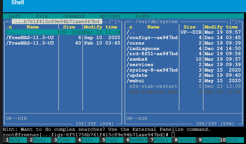

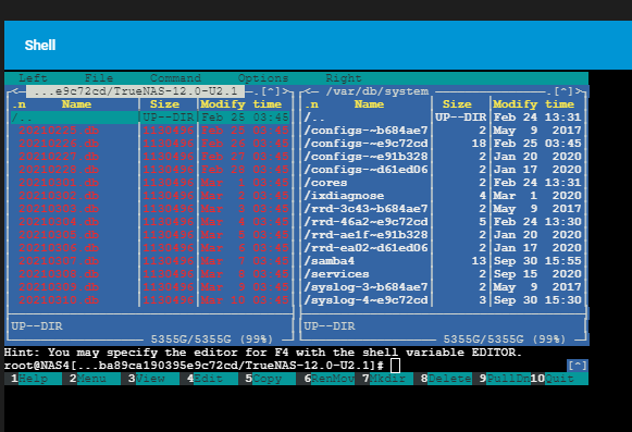

OK - arrowkey through that and fiond the latest dated version of the .db file. the next task will be to copy that file to your boot drive to replace the current .db file that you are booting with.
Lets first see what the latest file is that you have in there.
For example, mine is March 19.
needshelp
Dec 13, 2020
18
Look like Feb 10
Redcoat
Feb 18, 2014
2,922
So this should be not long before, if not the morning of, the crash?
needshelp
Dec 13, 2020
18
well could it be the last time it was shut down? It was left on for several weeks before the crash. I think the crash was more like end of Feb
Redcoat
Feb 18, 2014
2,922
OK, it's the best you have.
I'm presently trying to confirm the location on your boot drive to which this file needs to be copied - I cannot find my notes so I'm attempting to work it out "from scratch".
If anyone else here wants to chip in with the location and copying instructions, please do so - there's a minor domestic crisis on here at the same time and my attention is divided - I'll be back as soon as I can, hopefully I can prevent its transition from minor to major...
