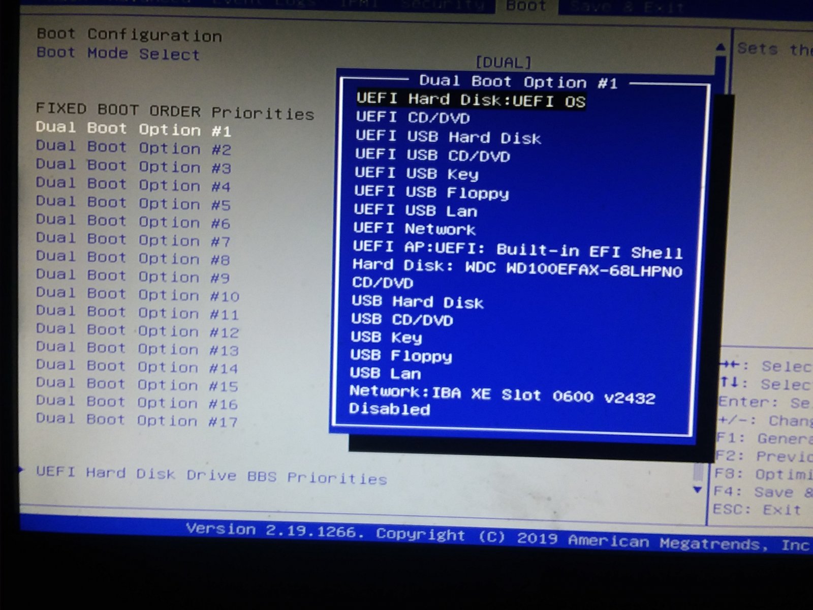

Do a screen copy of the Bios Boot Page and post it here so that we can see the list of devices to select from.
needshelp
Dec 13, 2020
18

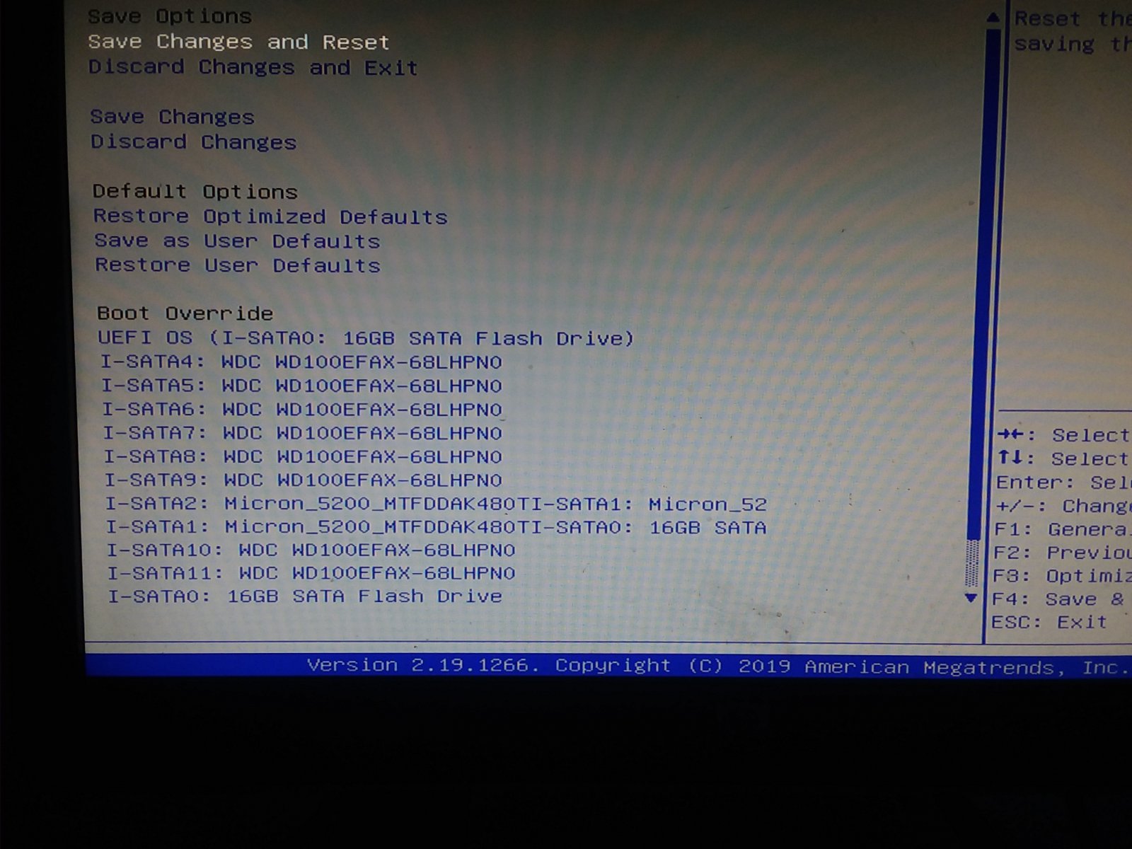

Here are scree
n shots
Redcoat
Feb 18, 2014
2,922
Hmm.., well, I don't see your SATA DOM boot device listed. I wonder if it has croaked?
I suppose you could try the one that's currently selected. It won't be anything with "usb", it's not the WDC listing (that's one pf your data drives), it's not CD, and it's not Network, I don't know what AP:UEFI is.,

There is an item in a boot override menu that has a UEFI OS (I-SATA0: 16gb sata flash drive)
Redcoat
Feb 18, 2014
2,922
Yes, that could very well be it - I had thought it might be larger than 16GB
According to the manual info it should be in the SATAIII_M0 slot. That could check with the SATA0 reference.

so an update an more help needed :(
so that boot override menu didn't do anything. Ixsystems sent me a new sata dom which I successfully installed and have the machine up and running. I then imported a config file when I first set up the machine but it set up my old pools which I did not expect. I want to import my pools I had right before this crash but when I try import pool it does not list any pools. I really hope my data is not gone.
