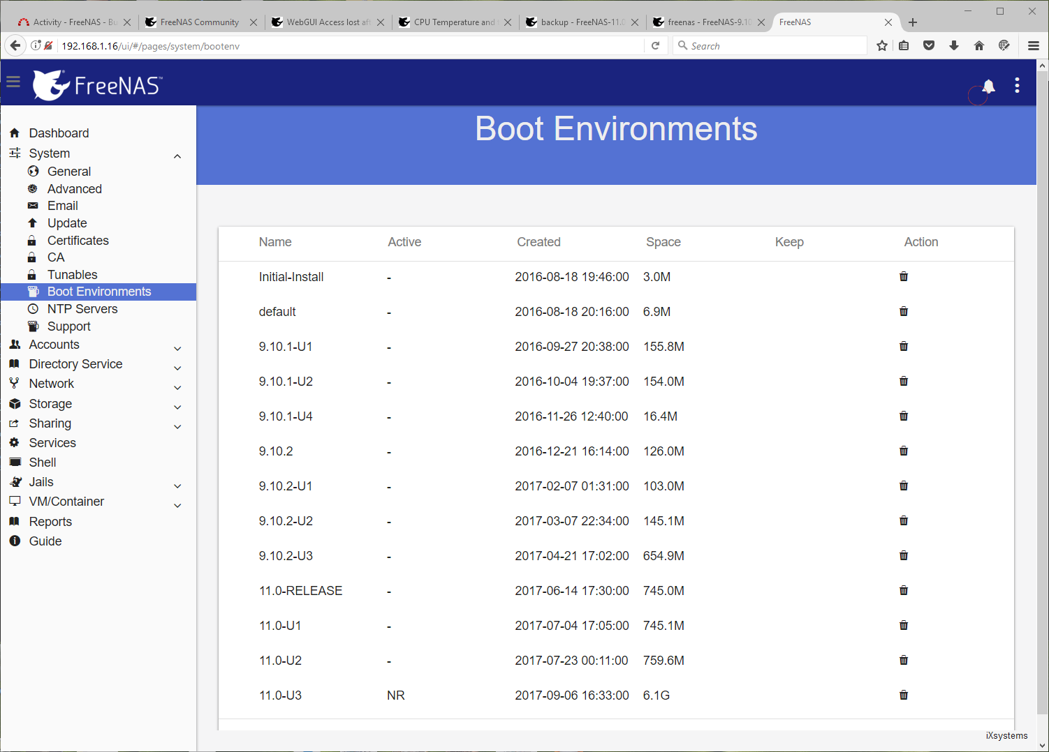

Here's an example. Apologies for the image, but zfs list is harder to interpret due to how boot environments are created (they're clones of snapshots of the original environment, which has been edited over time).
9.10.2-U4 through -U6 are all 650+MB on my other server, which is still on the 9.10.2 train, whereas this one moved to the 11 train before 9.10.2-U4 was released.
(Note that the latest environment is reported with the total size of all the snapshots, not including the datasets cloned from them, so it's slightly lower than the total used space.)
For those who are curious, here's the zfs list output:
