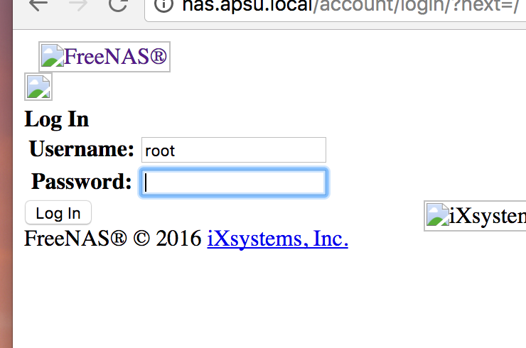

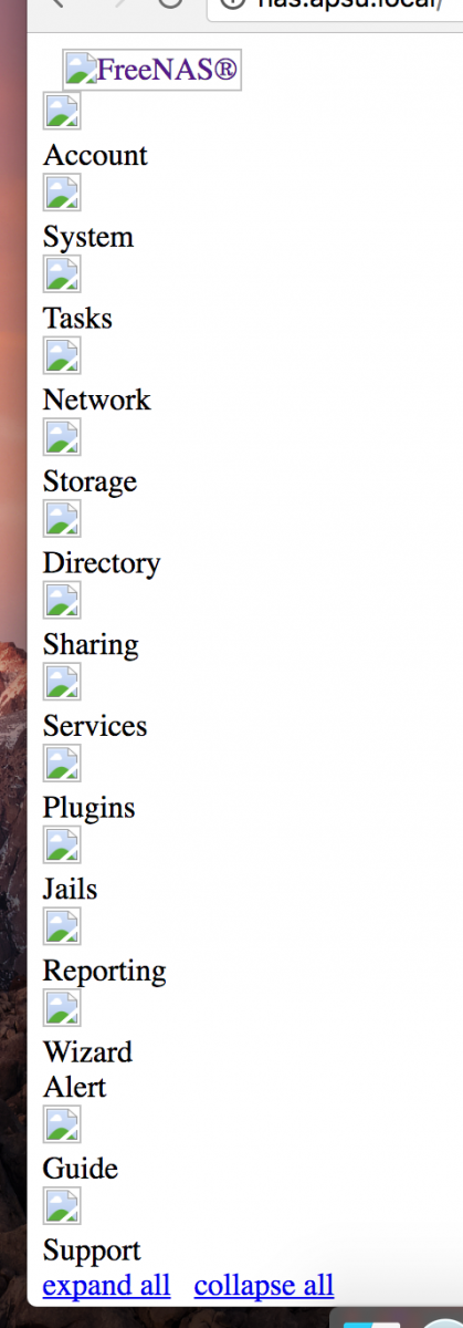

Dear community,
I'm seeking your advice here - i'm on 9.10, when I checked two days ago it was most recent version, no update pending.
I don't remember doing anything to the system but configuring permissions on my media volume to get Plex running.
When I tried to log on to the Web UI earlier today it appeared cluttered and broken, see attached. I tried using multiple web browsers and different OS, all the same. Cache cleared too.
I'm new to FreeNAS but found out that django is the UI framework so I restarted that (incl. nginx).
Any idea?
Thanks and regards
JD

I had the same problem after an update earlier today. I used the boot menu to go back the the previous version which started up as it should. Then, I updated to the latest STABLE version. When it rebooted, it seems to work just fine.
