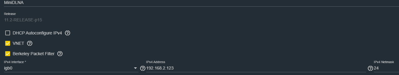

get it when trying to install MiniDLNA after update U6 ->U7
root@MiniDLNA:~ # pkg install minidlna
The package management tool is not yet installed on your system.
Do you want to fetch and install it now? [y/N]: y
Bootstrapping pkg from pkg+http://pkg.FreeBSD.org/FreeBSD:11:amd64/quarterly, please wait...
pkg: Error fetching http://pkg.FreeBSD.org/FreeBSD:11:amd64/quarterly/Latest/pkg.txz: Non-recoverable resolver failure
A pre-built version of pkg could not be found for your system.
Consider changing PACKAGESITE or installing it from ports: 'ports-mgmt/pkg'.
OS Version:
FreeNAS-11.2-U7
will appreciate any suggestions
9,703
Is the jail using VNET?
GolDenis
Oct 25, 2019
38
Yeap...
9,703
I have seen many folks having big problems when assigning static IP addresses in iocage jails on the current versions.
Can you use DHCP. I reserve my jails IP addresses by MAC address and have no issues.
GolDenis
Oct 25, 2019
38
guys! You are a genius...
Change to DHCP & I'm in!
thanks a lot!
