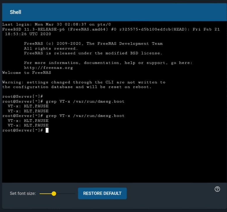

hello, I executed the command and this appeared ... what does it mean?

Here is what I get:
root@freenas[~]# grep VT-x /var/run/dmesg.boot
VT-x: PAT,HLT,MTF,PAUSE,EPT,UG,VPID
Note that I have Xeon E5-2630 CPUs.
I know that on an old Dell PowerEdge 2940 III I could not run VMs on that server as it did not have all the virtualization features required.
I suspect that you don't have all the CPU features required for virtualization.
