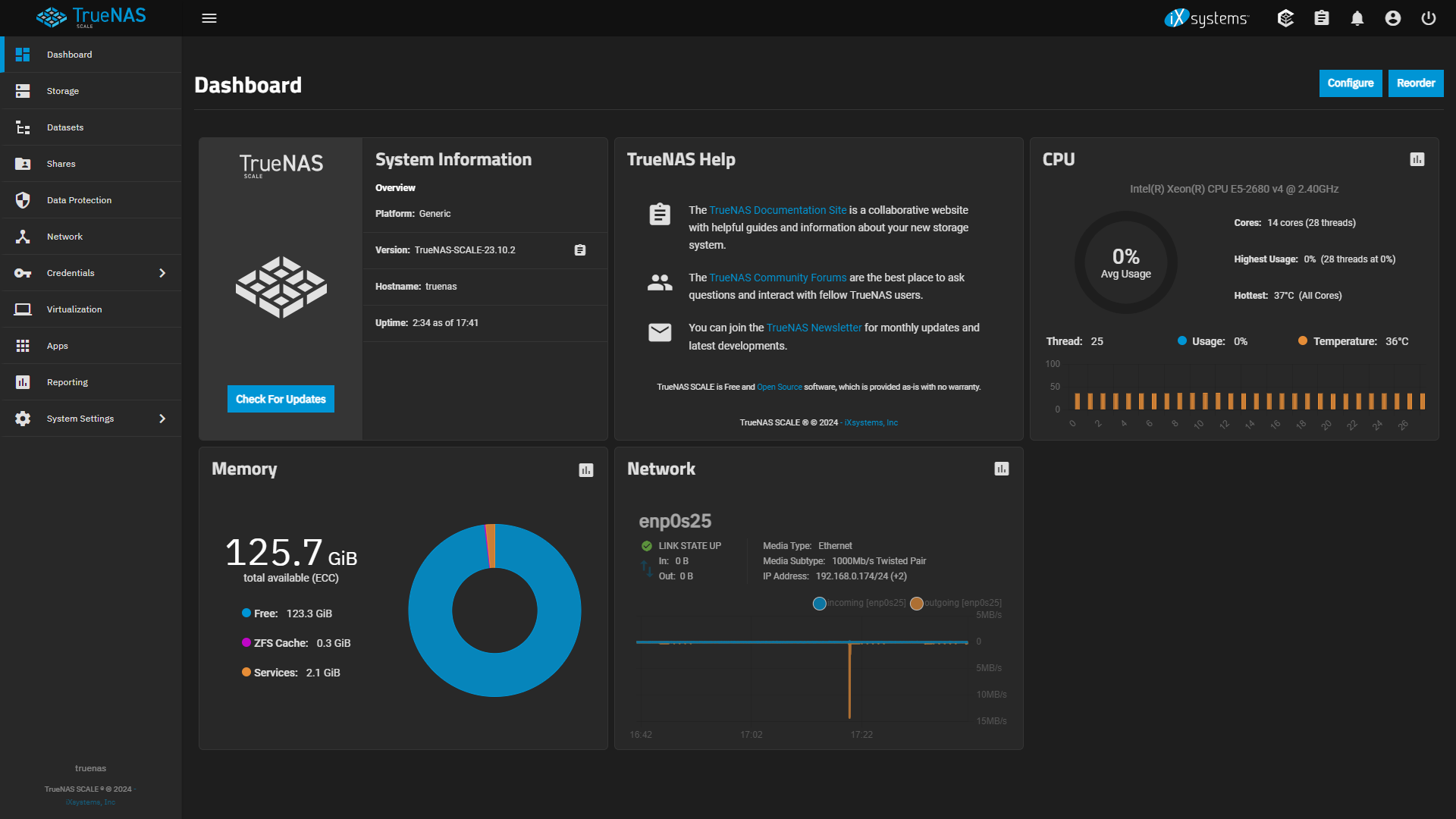

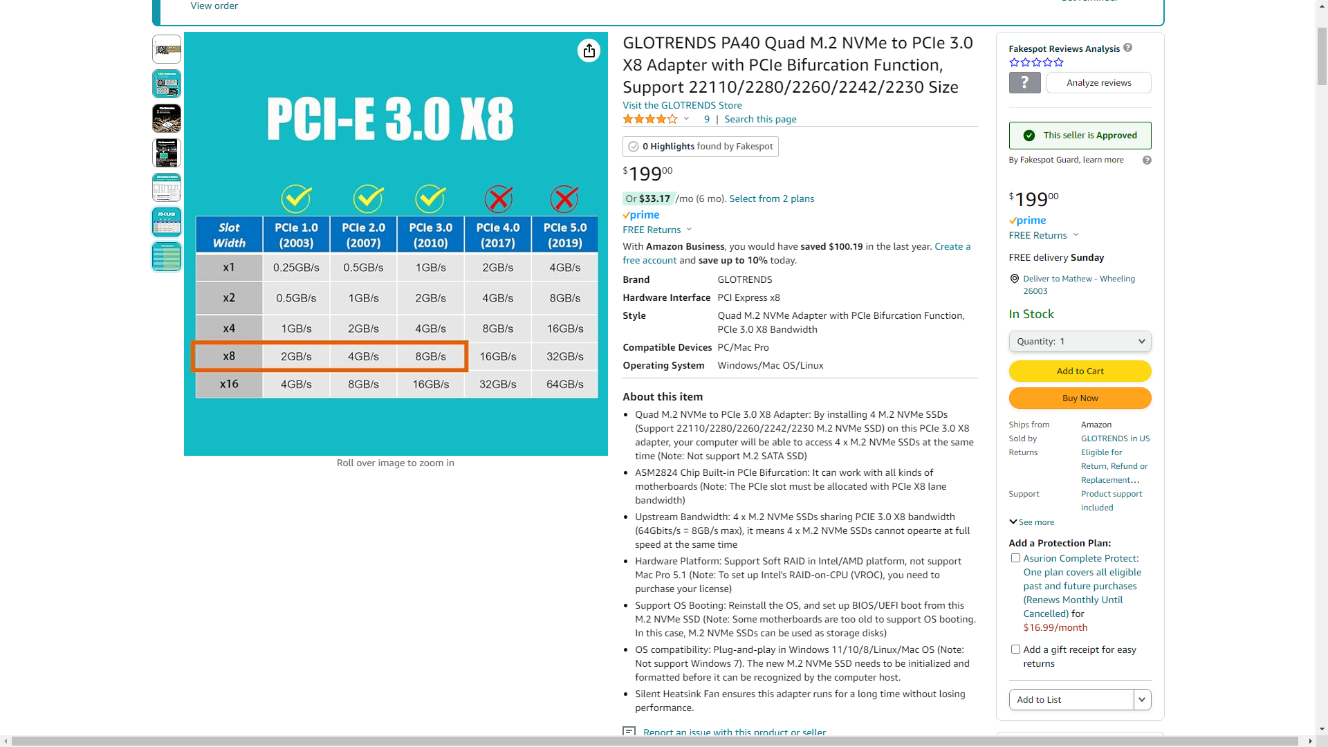

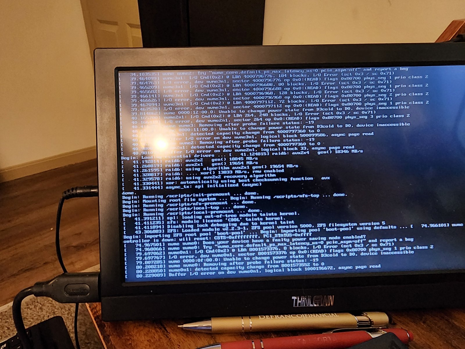

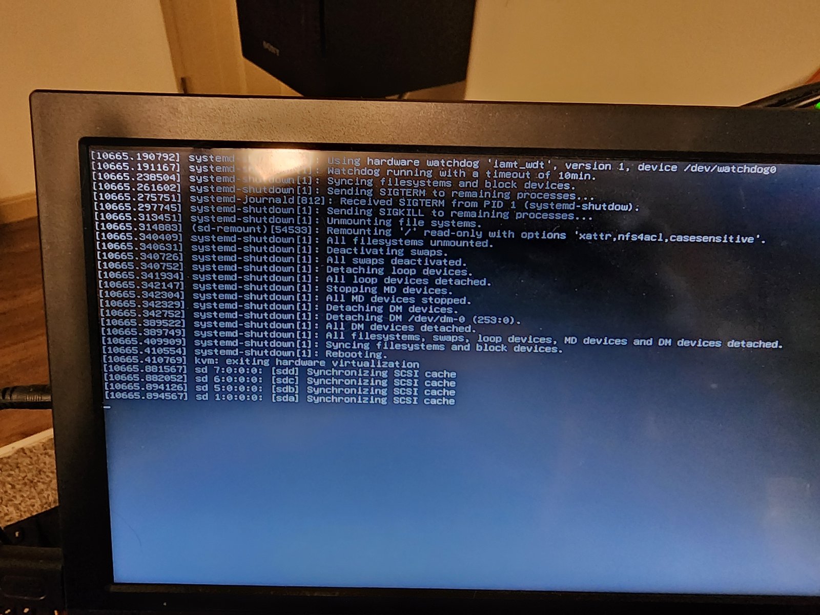

As I stated above my Server is a Dell Precision 5810T with 3 Ironwolf 10 TB HDD and 4 NVMe SSD as above (one 4 TB and three 2 TB SSD} the adapter is the GLOTRENDs PA40 Quad M.2 to PCIe 3.0 x 8 Adapter( below is a screenshot of the adapter info from Amazon and one of my Dashboard. I purchased 4 new A-TECH 32GB RAM Replacement for Micron MTA36ASF4G72PZ-3G2 | DDR4 3200MHz PC4-25600 ECC RDIMM 2Rx4 Server Memory which works great. I also purchased a Acer Predator Graphic Card BiFrost Intel Arc A770 2.20GHz OC which seems to be working fine. when I rebooted the server its been stuck at the attached screen picture 3675. I forced a reboot and was able to take a few photos where I saw the error in 3677 nvme does your device have a faulty power savings mode? I then swapped PCIe lanes with the GPU and rebooted and all was well. Sorry I went on so much but decided to post incase someone else had a similar issue
