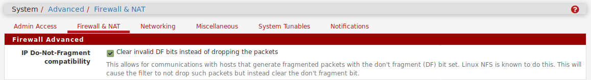

May 2, 2017
211
I wonder if you have some MTU/Do not fragment issues. With the VPN up, you are tunneling IP inside of IP. That means you likely lose 40 bytes or more of payload. That can cause packets to get fragmented, and windows is notorious for capriciously marking things as 'do not fragment' for no particularly good reason. Higher end routers can clear the 'do not fragment' bit in the IP headers. You could also try changing the system MTU to something smaller like 1400 bytes.
I looked at my pfSense configuration, and had already had that option set. See the screenshot.
