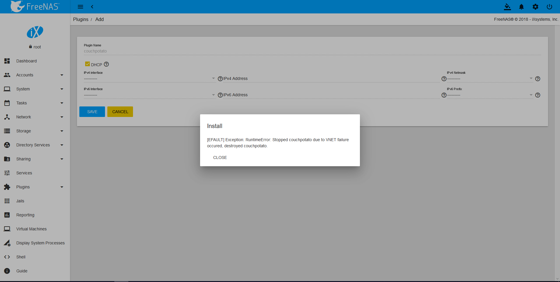

I'm new to FreeNAS and I am experiencing some problems since I always used NAS4Free for my servers.
When installing any plugin with dhcp enabled (plugin setup/install page) I get the error:
[EFAULT] Exception: RuntimeError: Stopped couchpotato due to VNET failure occured, destroyed couchpotato.

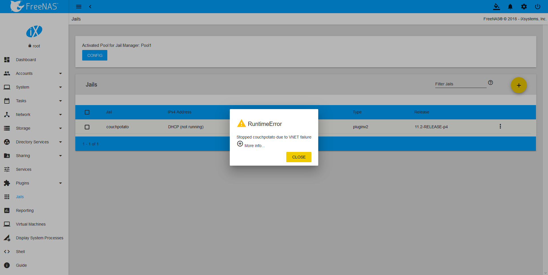

So after disabling dhcp I noticed my jail couldn't connect to the internet, I enable VNET and entered the default IPv4 route --> Plugin GUI page can't load
Then i enabled DHCP Autoconfigure IPv4 --> Stopped couchpotato due to VNET failure
(I get this error with all plugins when enabling dhcp / DHCP Autoconfigure IPv4)
