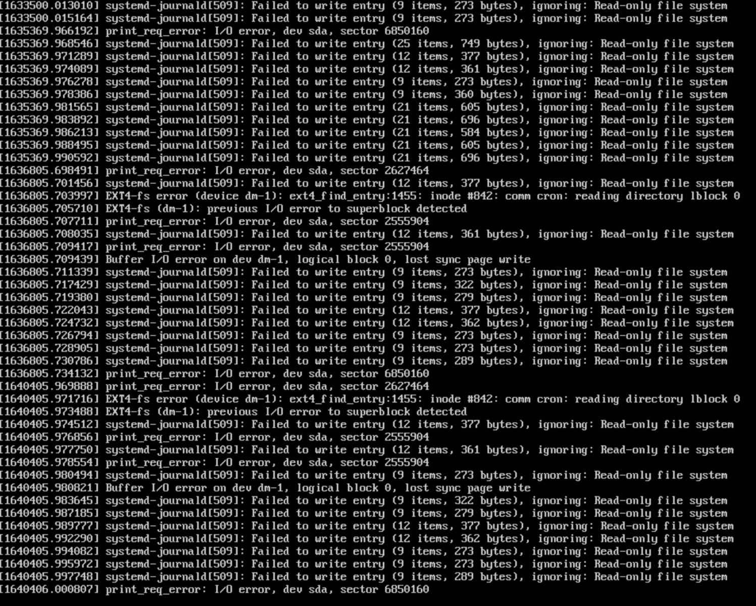

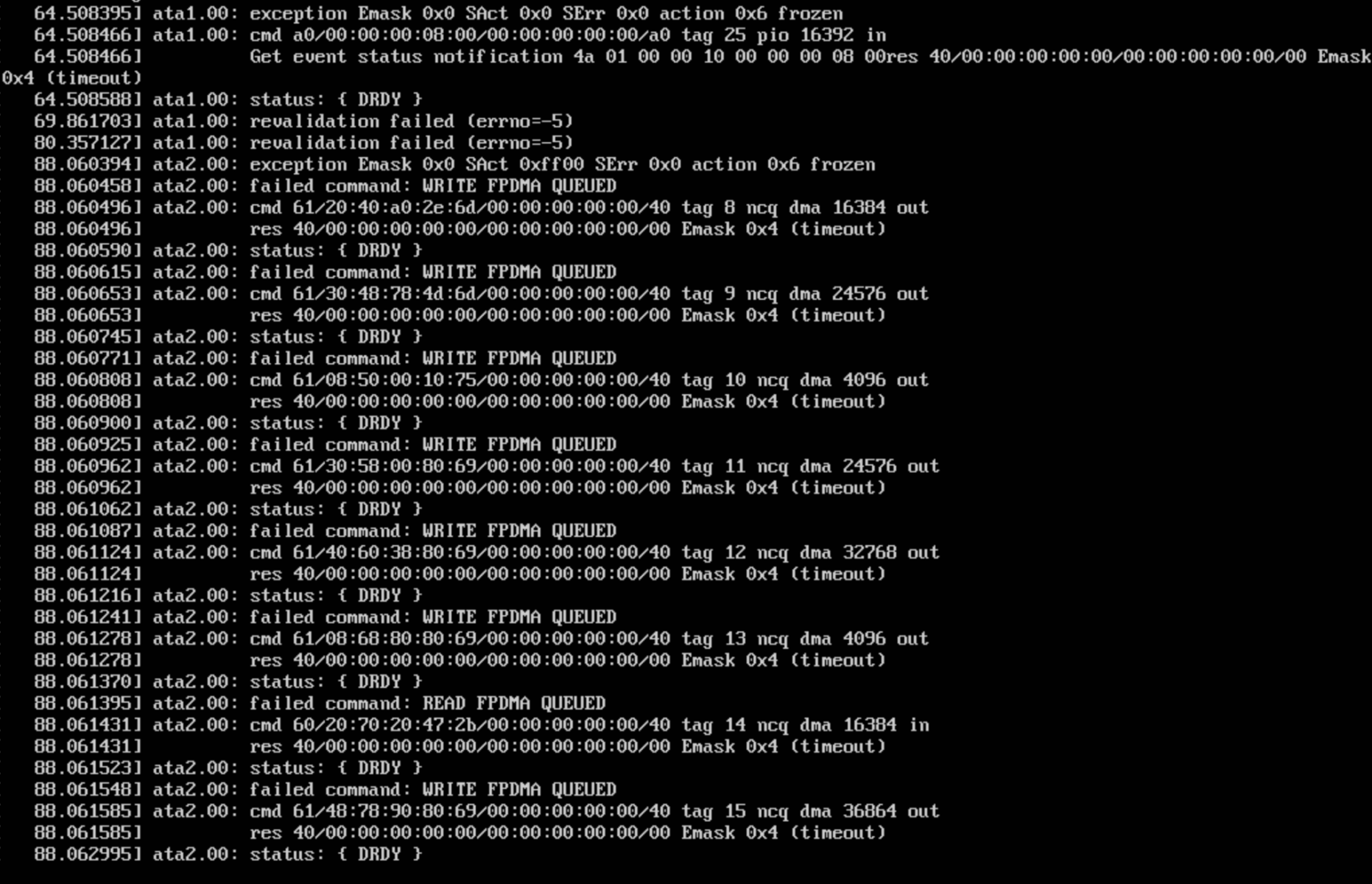

Here are some screenshots, it goes on like this..
I was wrong, it can actually boot, but it ends on login screen and then these errors start. It's not possible to login.
