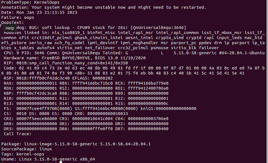

Here is a screenshot of one of the crash logs
9,700
Interesting that the VM thinks it has 9 (or maybe 10) CPUs...
According to your post, it should only have 8, so indeed CPU 9 or 10 will respond slowly.
I would suggest running with only 2 cores, 2 threads and see if you get stability.
So, I get noticeably better performance but the VMS maxes out the CPU. I also tried 6 cores with 1 thread, but it also maxes the CPU. It is no longer crashing but the performance graphs are all over the place. Nothing is steady unless it's maxed out.
