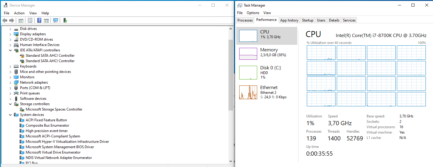

1) First i see AHCI controller driver missing? Not sure why? i tried to see if the latest virtio-win-0.1.189.iso has the drivers but nope. I think on qnap i used virtio but here i cant boot if i use that.
My controller card is this: https://www.broadcom.com/products/storage/host-bus-adapters/sas-nvme-9405w-16i
The only driver i can get from brodcom did not help or install anything useful (sorry i'm sort of a noob at this).

2) I dont get why i see so many cores!? I set the following Virtual CPUs:2 Cores:2 Threads:4
Not sure how it calculate but i assume 2 real core and 4 thread should use 2 of my cpu cores which i have 6 of (i7 8700k). I should be seeing 4 logical right?

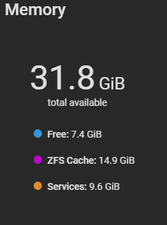

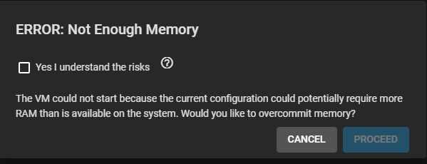

3) and lastly (i hope) i get a warning about memory. I tried to google and read allot on this but there is no easy answer i think. I have 32G of memory and right now 7 is free.

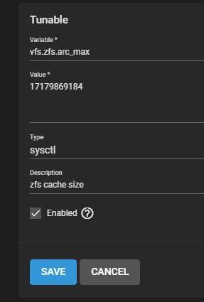

I did set this (read from here:https://www.reddit.com/r/freenas/comments/gdaeoz/tweak_adjust_zfs_cache_size_113/)
which i think reduces my zfs cache a bit (have to try some more) but still i get the warning when i start the VM that is suppose to use 6G even if i have 7-8G free

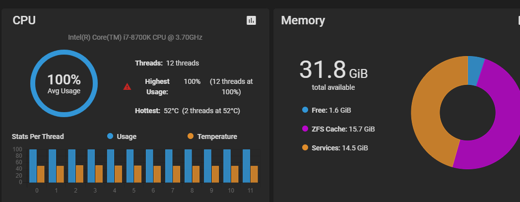

4) I experience is that the VM is very slow. Considering the spec i have it locksup time to time and i cant even play a youtube video properly. And just now i started the VM before posting this and after maybe 10min my remote desktop disconnected and i see
I had to do a Power off the VM.
Just for reference and my experience, i been running win10 VM on my QNAP for maybe 3 years and i have 3 core and 6GB memory on an Intel i5 and it works so much better.
