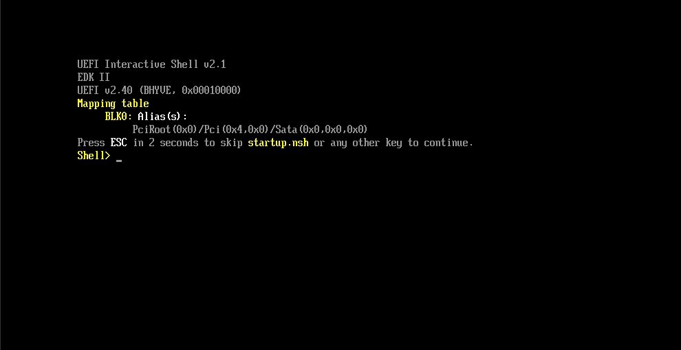

I recently updated my FReenas and now have a problem with one of my VMs. I deleted it and than setup again with the ZVOL. It starts but I get an error. (See attached)

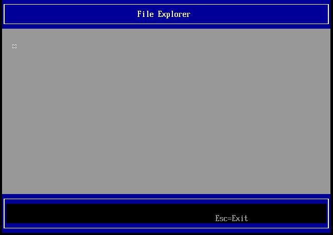

So I wanted to repair that in the Boot Maintenance manager (see attached) and then boot from file.
But there's no option to choose (see attached)
Any suggest what to do here?

OK, you've made that clearer now. Your screenshots imply your trying to boot a VM in UEFI mode but the boot disk is not being found. You did check the VM disk device is pointing to the correct zvol? Have you tried doing this via the old UI in FN11.2 beta?
Yes correct. Till FN 11.1 it was running without issues. After Update it did not start. So I deleted the VM and re-setup it with the existing ZVOL. However as shown in the screenshots it does not find a bootfile.
