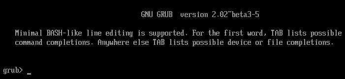

Upon GUI VM Start, my VNC shows that the install has stopped at grub. See attached.
Could anyone suggest steps to move forward?

I initially tried a light weight ISO: debian-9.2.1-amd64-netinst.iso and I still don't know why it hung on grub.

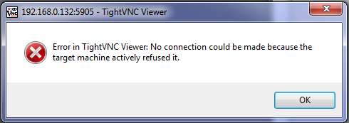

  • After reboot... Error in TightVNC Viewer. No connection could be made because the target machine actively refused it."
  • But I think I know why this happened: instead of removing the Device from the VM in the GUI, I had quickly moved the ISO out of my ISO folder on the zpool (up one directory). That's gonna confuse bhyve.
  • I stopped the VM, removed the CDROM device and re-started the VM

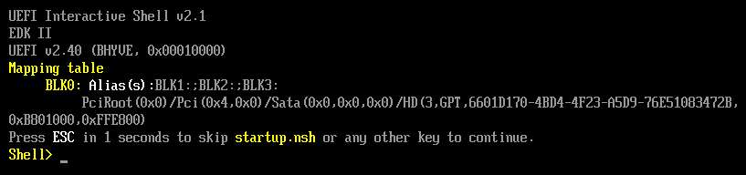

  • Now I see the not-so-dreaded UEFI Shell screen that others have noted here https://forums.freenas.org/index.php?threads/how-to-how-to-boot-linux-vms-using-uefi.54039/page-5
  • So... next I will follow the suggestions by Rybena at https://www.youtube.com/watch?v=GjMIgkC5REM&t=603s

I can't explain your problem, as I couldn't reproduce it using the debian-9.2.1-amd64-netinst.iso. I presume you created the zvol before the VM, so perhaps is was a bhyve VNC quirk. It's a good idea to install and configure ssh in your VM ASAP.

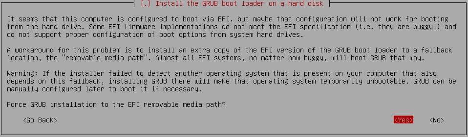

Also for future reference if you choose debian's expert install option when you reach the "install grub loader" option you will be prompted to Force grub-efi installation to the removable media path. Answer "yes" and there will be no need for a post-install UEFI fix.
See here for Debian's argument why this is not a default option:
https://wiki.debian.org/UEFI#Force_grub-efi_installation_to_the_removable_media_path
This is equivalent to executing this command post-installation as root:
grub-install --efi-directory=/boot/efi --boot-directory=/boot --removable
You will find the necessary dir/files have been created, e.g:

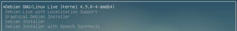

1. Debian Live does not seem to have an expert install option (see uploaded image). So, I went back to the netinstal path since you said you could not replicate my grub stall issue.
2. Then found my grub stall issue: my initial netinstall wget did not complete.
-rw-r--r-- 1 root wheel 4186112 Nov 27 15:14 debian-9.2.1-amd64-netinst-OLD.iso
-rw-r--r-- 1 root wheel 304087040 Oct 13 06:10 debian-9.2.1-amd64-netinst.iso
So, I re-grabbed the ISO and ran the bhyve VM build process from GUI, and then happily got to Debian netinstall main page and was able to select expert install. Easy from there.

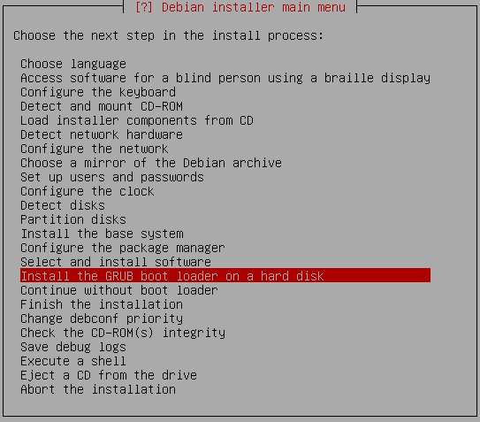

In sum, recommendations for Debian 9 VM builders (newbies like me):
  1. Netinstall works fine (as long as you have the full file)
  2. At Debian GNU/Linux UEFI Installer menu, choose Advanced options...
  3. Then choose Expert install
  4. At step 16, Install the GRUB boot loader on a hard disk step... Select Yes for Force GRUB installation to the EFI removable media path?
