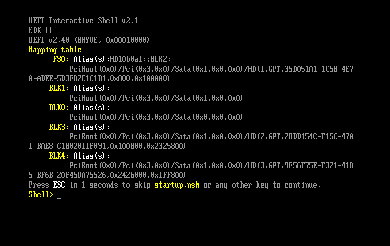

Hi guys,
I have been installing Debian 9 as a Virtual Machine and everything is peachy until I decide to power off the VM.
Upon restart of the VM, it gets stuck in the UEFI Shell.
I have done a few other VM install with different OS'es and all of them failed after a while. I thought the issue was related to the various Freenas updates, but this doesn't seem to be the case.
Any idea where to look to solve this issue?

@scrappy, Thanks. I am able to boot into Debian manually. I just need to make it permanent.
KrisBee
Mar 20, 2017
1,288
Looks like you might need this:
For Debian 9 use expert install and answer "YES" when ask to "Force grub-efi installation to the removable media path". Or, post install don't try copying files around, just use this command:
grub-install --efi-directory=/boot/efi --boot-directory=/boot --removable
