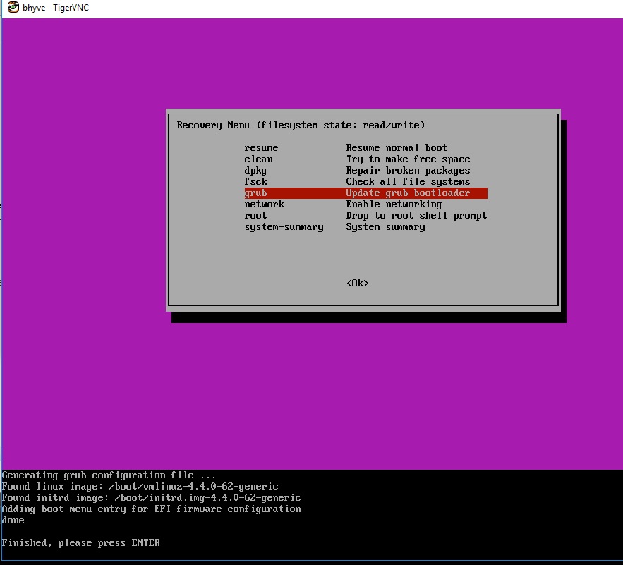

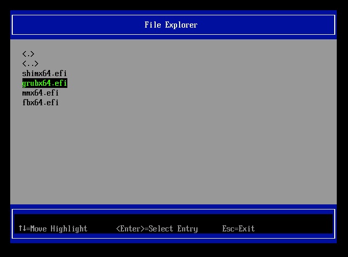

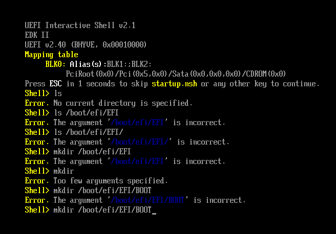

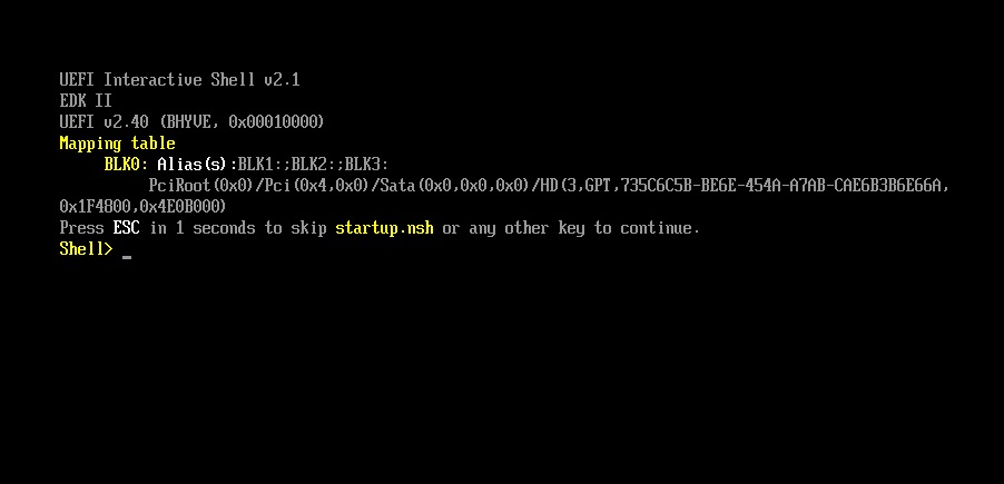

I'm on FreeNAS 11.0-RC3, I've installed Ubuntu 16.04 (UEFI) on the WebGUI everything is good but, every reboot, the OS doesn't come back automatically. I get stuck in the "UEFI Interactive Shell v2.1" - I then need to connect via vnc and go to Boot Maintenance Manager-> Boot From File -> No volume label, pciroot... ->EFI -> Ubuntu -> grubx64.efi
I thought it was a problem with grub, so i've boot in recovery and run a grub update for the bootloader, but still the same issue once i reboot.
