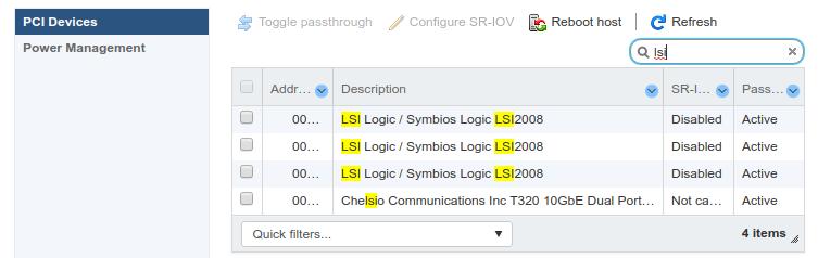

I have 3 SSDs on the MB SATA ports: A Small one for ESXi boot and two 1TB for Datastore. The server has three LSI in pass through:
