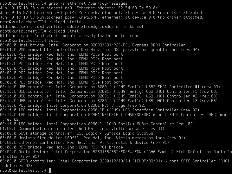

I've successfully loaded the virtio modules in FreeNAS. But when I switch the NIC to virtio, I can't figure out how to make FreeNAS associate the device with the driver. I end up with the attached screenshot. As you can see, the Red Hat, Inc. Virtio network device is listed. And at the top, the last two lines of the grep output are from when I had the NIC set to virtio, they say "no driver attached".
If I run ifconfig, it just lists the 'lo' network.
Once I switch back to the 'rtl8139' device model for the NIC, it works just fine.
While drafting this post, I hit upon the idea of adding a second NIC for the virtio NIC, that let me ssh into the vm and copy out the output.
So, here's info I was able to gather:

root@xunlaichest[~]# grep -i ethernet /var/log/messages
Jun  9 15:18:23 xunlaichest re0: Ethernet address: 52:54:00:7e:50:8e
Jun  9 16:57:04 xunlaichest pci4: <network, ethernet> at device 0.0 (no driver attached)
Jun  9 17:13:37 xunlaichest pci4: <network, ethernet> at device 0.0 (no driver attached)
Jun  9 17:28:23 xunlaichest re0: Ethernet address: 52:54:00:7e:50:8e
Jun  9 17:40:52 xunlaichest pci4: <network, ethernet> at device 0.0 (no driver attached)
Jun  9 17:40:52 xunlaichest re0: Ethernet address: 52:54:00:7e:50:8e
root@xunlaichest[~]# lspci | grep -i virt
00:01.0 VGA compatible controller: Red Hat, Inc. QXL paravirtual graphic card (rev 04)
01:00.0 Communication controller: Red Hat, Inc. Virtio console (rev 01)
03:00.0 Unclassified device [00ff]: Red Hat, Inc. Virtio memory balloon (rev 01)
04:00.0 Ethernet controller: Red Hat, Inc. Virtio network device (rev 01)
root@xunlaichest[~]# kldload virtio
kldload: can't load virtio: module already loaded or in kernel
root@xunlaichest[~]# kldload vtnet
kldload: can't load vtnet: module already loaded or in kernel
I also checked ui/network/interfaces/add to see if I could find another NIC listed. It just had the re0 'rtl8139' device available, which was already configured. No sign of something for the virtio device.

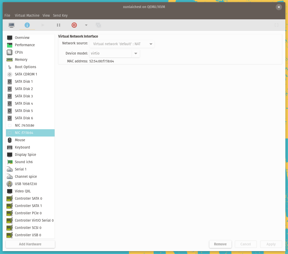

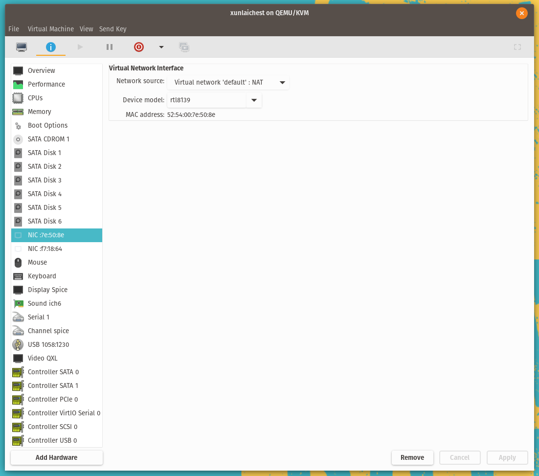

For your VM network to be usable you need to have configured a bridge on your host...
Um, I have the default virt-manager network selected for both cards. See the attached screenshots. When I had only the virtio nic set up, it was set to use the default network. Since it works on the non-virtio nic, why wouldn't it work with the virtio nic?
I also just tried telling the virtio nic to use the virbr0 network bridge. It didn't help. The nic is still detected, but no driver is loaded for it.
With this setup, when I use option 1 from the console, it only lists the non-virtio network as an option.

2 nics let me ssh in via terminal and copy output from commands. Much easier than screenshotting or hand typing it.
I did try 1 virtio nic. If I configure it to use the default network (that works with the non-virtio nic) it does not work.
The only difference is virtio vs. not being virtio.
I'm pretty sure a 'network' is effectively just a virtual ethernet cable, so if an ethernet cable is plugged into a working network, but my pc can't access the net, then it's either the pc's network card, or the OS's driver having issues.
The default network is a bridge. See the attached screenshot.
So, from what I can see, the OS is not associating the virtio nic with the virtio driver. It loads the driver, and detects the nic, but doesn't make the two things work together.
Is there a manual method to associating a NIC with a driver?

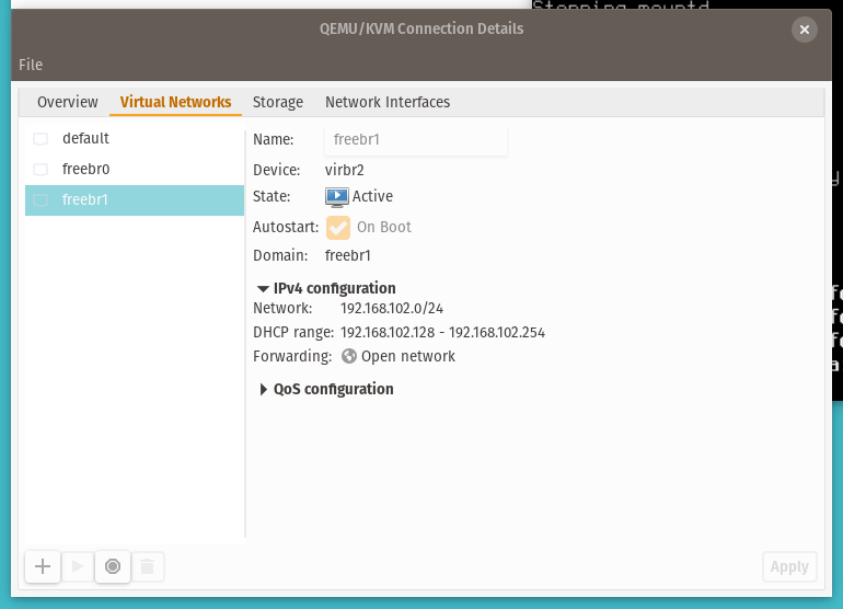

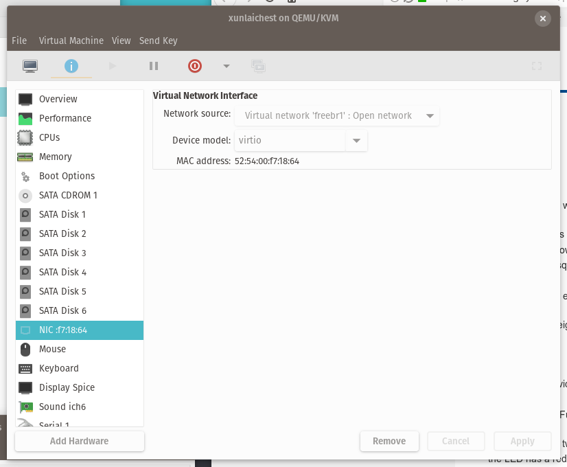

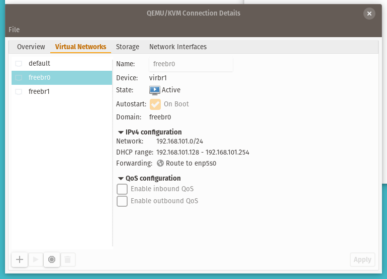

Ok, so I've tried configuring two additional networks. One with the Routed option, one with the Open option.
freebr0 (freebr0.png) is routed to my hosts nic.
freebr1 (freebr1.png) uses the "Open network" option.
When configured as the sole NIC using the virtio option, neither freebr0 (nic-freebr0-virtio-broken.png), nor freebr1 (nic-freebr1-virtio-broken.png), work. FreeNAS says "The web interface could not be accessed. Please check network configuration." If I try to configure network interfaces via option 1, no interfaces are listed.
When configured as the sole nic using the rtl8139 or e1000 options, freebr0 works just fine. FreeNAS detects and configures it automatically. I can access the Web UI via the ip address shown in the console after boot.
When configured as the sole nic using the rtl8139, freebr1 (the open network) is detected and configured, but the ip address shown after boot is 0.0.0.0. So, I'm not counting that as working.
As far as I can tell, between the default NAT network, and the freebr0 and freebr1 networks, I've covered every possible kind of virtual network. All three "work" if I don't use virtio. That is what makes me think something is wrong with how the virtio network driver is being loaded.
