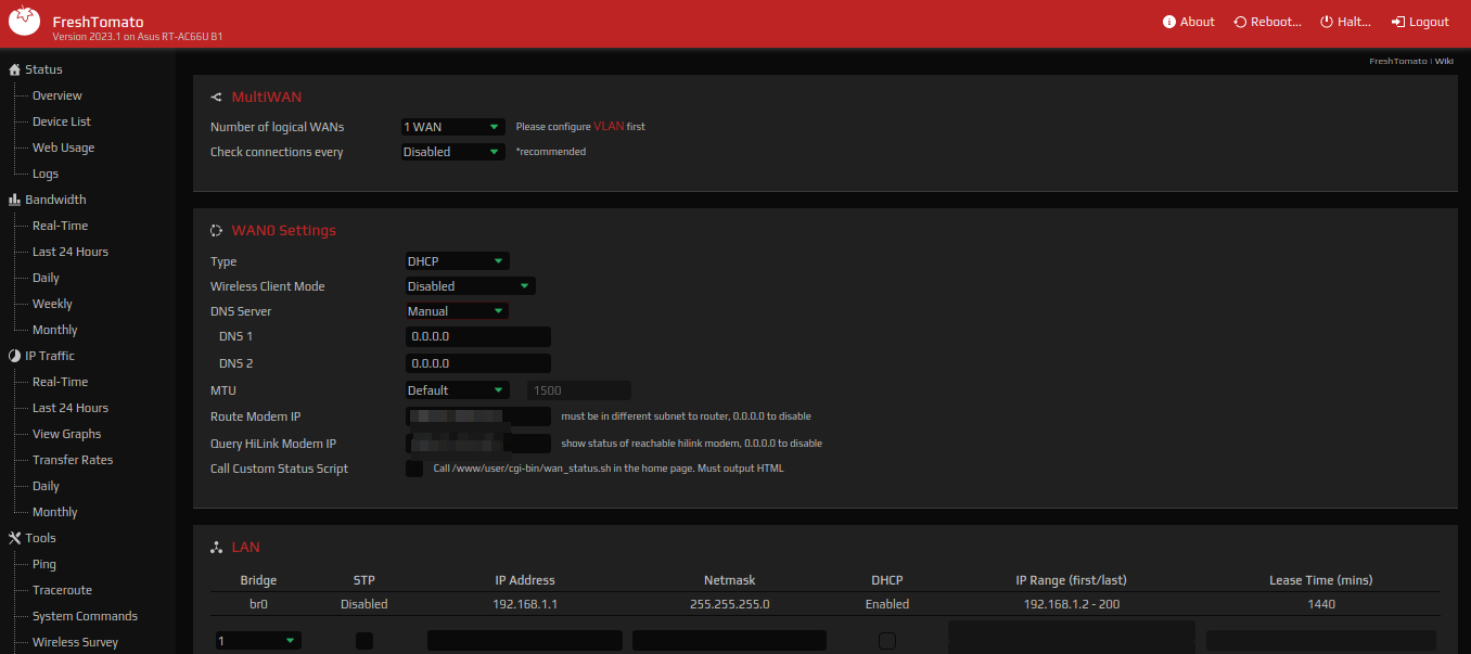

Well my setup is extremely simple:
A FIber optics box connected to the main router that is using a custom FW (Fresh tomato) which has 4 Gigabit Ethernet ports: 1 is used for my other room Linux machine, 1 for my living room Linux machine, 1 for my small hosting server and last one for Trunas. So now I do not use any Switch just to make things simple for our diagnostics.

Yes, regular Cat6 ethernet from router to the devices without anything else.
These are my router's Network settings:
9,700
The 4 LAN ports on your "router" are effectively a LAN switch.
You have already shown so far that at least two of the ports on it are potentially involved in being no good...
We need to work through the variables to eliminate the possible sources of the drops, so we might also consider putting two devices on your additional switch to test that instead.
Also remember that we're testing cables at the same time here, so pay attention to which ones are used in each test.
