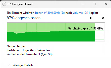

With the TCP settings recommended by Mellanox for 40GbE, I get an average of 1.3 GB/s for files from Disk and 2 GB/s for files from ARC with e.g. big ISO files copied via file manager.

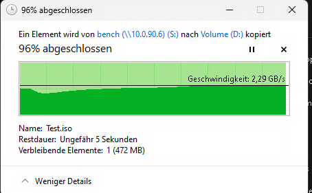

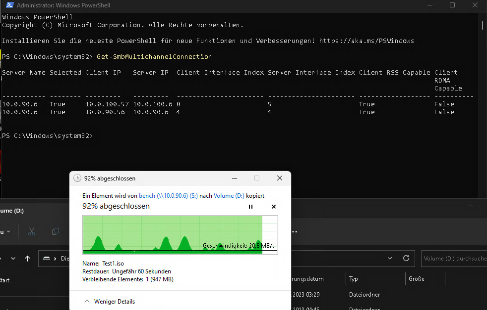

With SMB Multichannel and Mellanox TCP settings, I get up to 2.4 for reads from ARC and up to 3GB/s writes to Truenas, but everything from Disk is unuseable slow, the transfer speed varies between 30 MB/s and max. 100 MB/s
SMB Multichannel works without Sysctl changes, but with Mellanox TCP settings normal SMB is faster.
