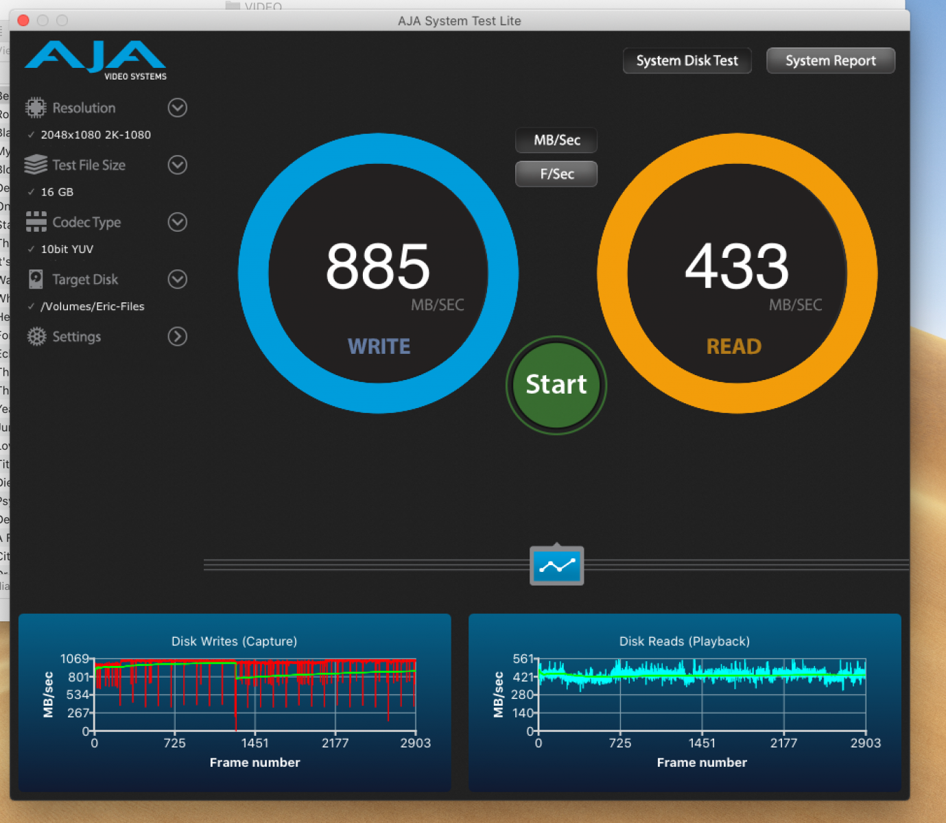

the plot thickens.
I copied my pool to freenas 11.
rebooted with my old freenas 11 USB key (instead of SSD).
I did a 10GBe to freenas (10GBe) disk test and sure enough, I was not dreaming. I got great speed again.
here the 2 screenshots from client, running Aja. (disk cache on Aja client disabled), any caching would be done on the server.
You can see that the 2nd pass is higher, (as expected). 1004MB/s vs 885MB/s
and this is all in the RAM really as my current pool is hosted on the USB 3.0 HDD drive. (only capable to do 130MB/s on a good day)

Also, instate doesn't show much activity when doing this test, again, probably all RAM.

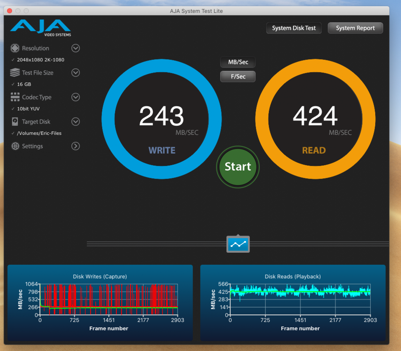

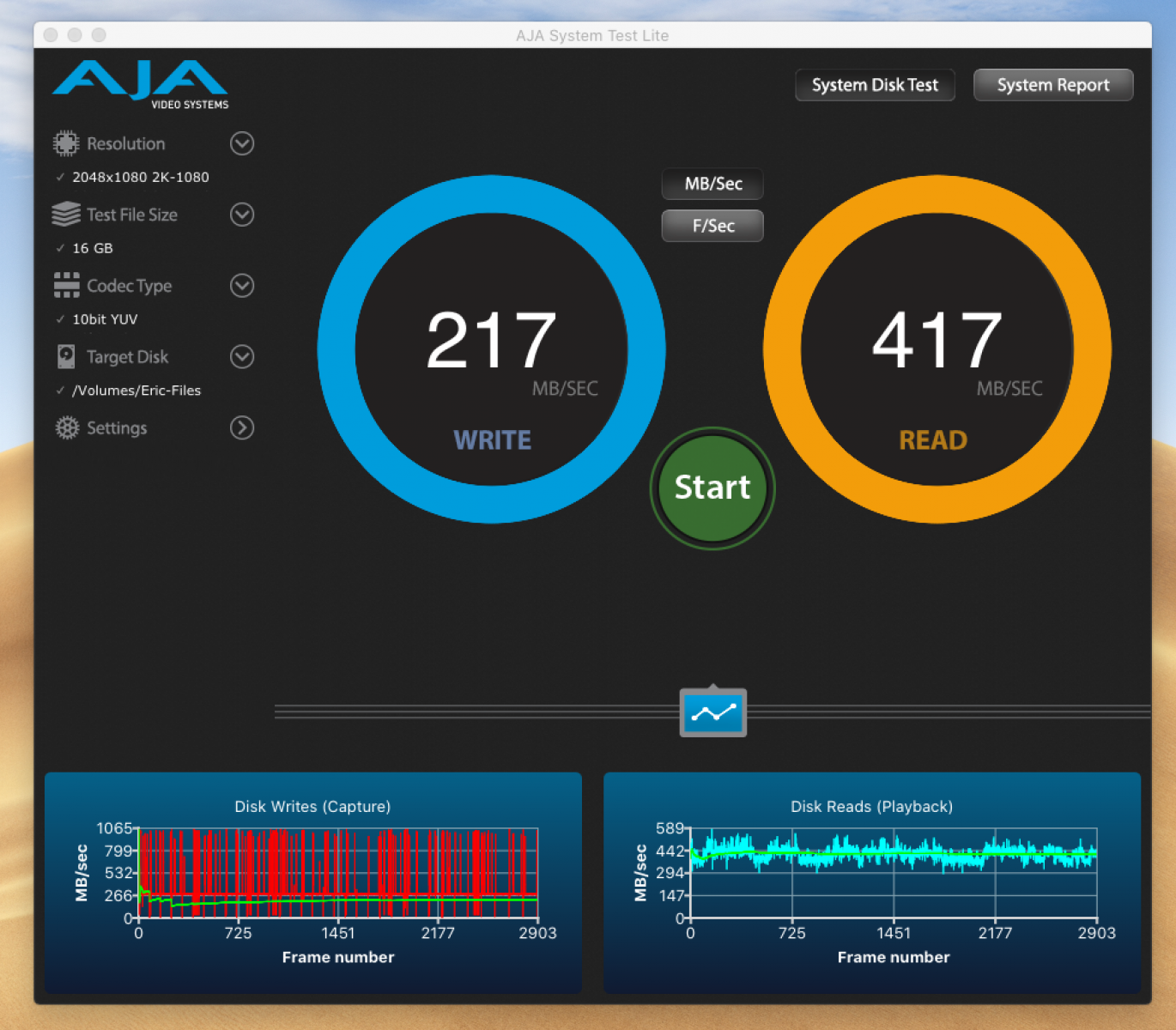

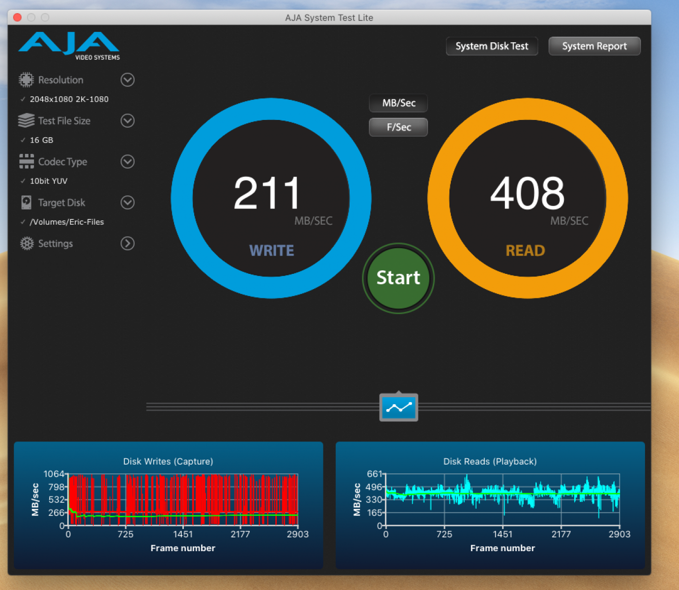

Ok, just rebooted in truenas.
Using the real pool (to SATA ports, zraid1):
217MB/s write, 417MB/s read
2nd test right after to see any cache influence:
211MB/s. write and 408MB/s read
I then tested truenas again, but this time using the USB 3.0 HDD.
243MB/s write and 424MB/s read
So, to me, the pool doesn't seem to matter, the HD might be ok. but there's something going on.
The only variables at play here are the version of truenas, and possibly its settings.
The rest remains the same, same drives, same network, same client, (the client is on nvme drive getting 2700MB/s locally).
If I'm the only one getting slower speed on truenas, where do you think I messed up? how to debug this?
(PS iperf3 for network is full 10Gbe, send & receive, on both freenas, and truenas)
