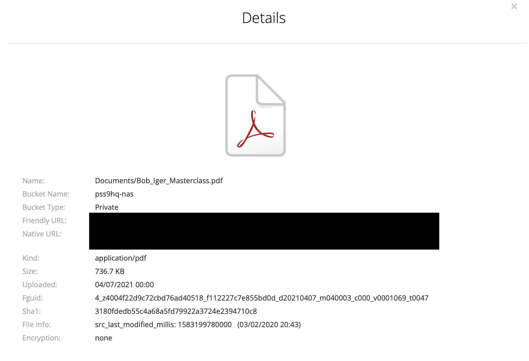

Do you know if it's easy to get the MD5 or SHA1 from Backblaze B2? I can't find anything on their site about it.
I'm wondering if I could make a snapshot in truenas of the dataset, delete one of the files, do a pull/sync and then verify it?

So I came across a Python script that would use the BackBlaze backup API. There is an API for B2, and B2 takes a hash of the file. I'm sure someone out there has written a script to use the B2 API to pull the SHA1 hashes and has the files in a directory and compare them...
