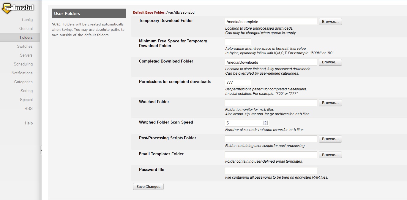

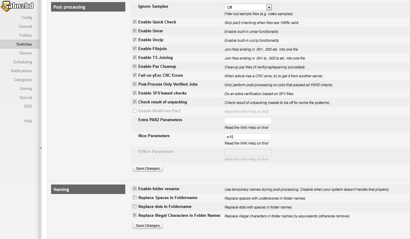

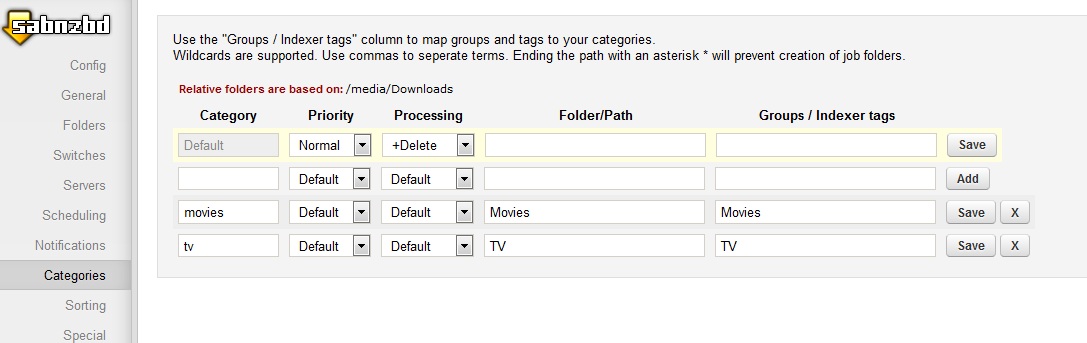

I have disabled any post processing from SickRage and I'm attempting to let Sab do it. I'm pretty sure I don't have a script running though, as I couldn't find it in the folders tree.
These are running in 2 separate jails. I attempted to follow your blog, but I ran into issues while trying to do it and just went back to separate jails.
I have attached pictures of my current settings in Sab.
I have a feeling I may need to just start fresh and set this up properly...

sabnzbd wont do any post-processing for you. you didn't set a post-processing scripts folder.
sabnzbd doesn't come with any scripts itself. Either point to the one sickrage comes with (which would be hard cause you're running them seperatly), or download nzbToMedia into your sabnzbd jail.
