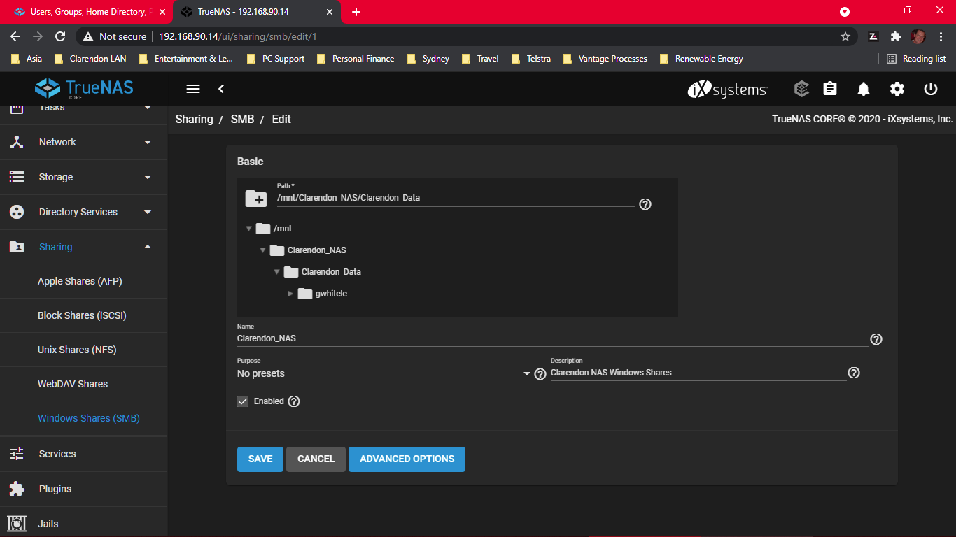

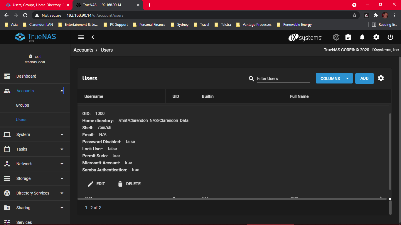

I must confess to being bamboozled by the 'Home Directory' and 'User' relationship (see screenshots). When I created the 'gwhitele' User, it added a subfolder by the same name to the Pool Share, below the Dataset 'Clarendon_Data' and I'm not clear on possible conflict between these parameters. Do I map to 'Clarendon_Data' or to 'gwhitele'? Neither seems to work.
9,702
You seem to be confusing things at all levels.
Can you browse to the shares? (which shares can you see?)
You should only see the directory structure in the share (nothing in front of it).
You should only need to map to the level above the username from W10, but if you can't get to the share that contains it, there's no point even thinking about mapping something.

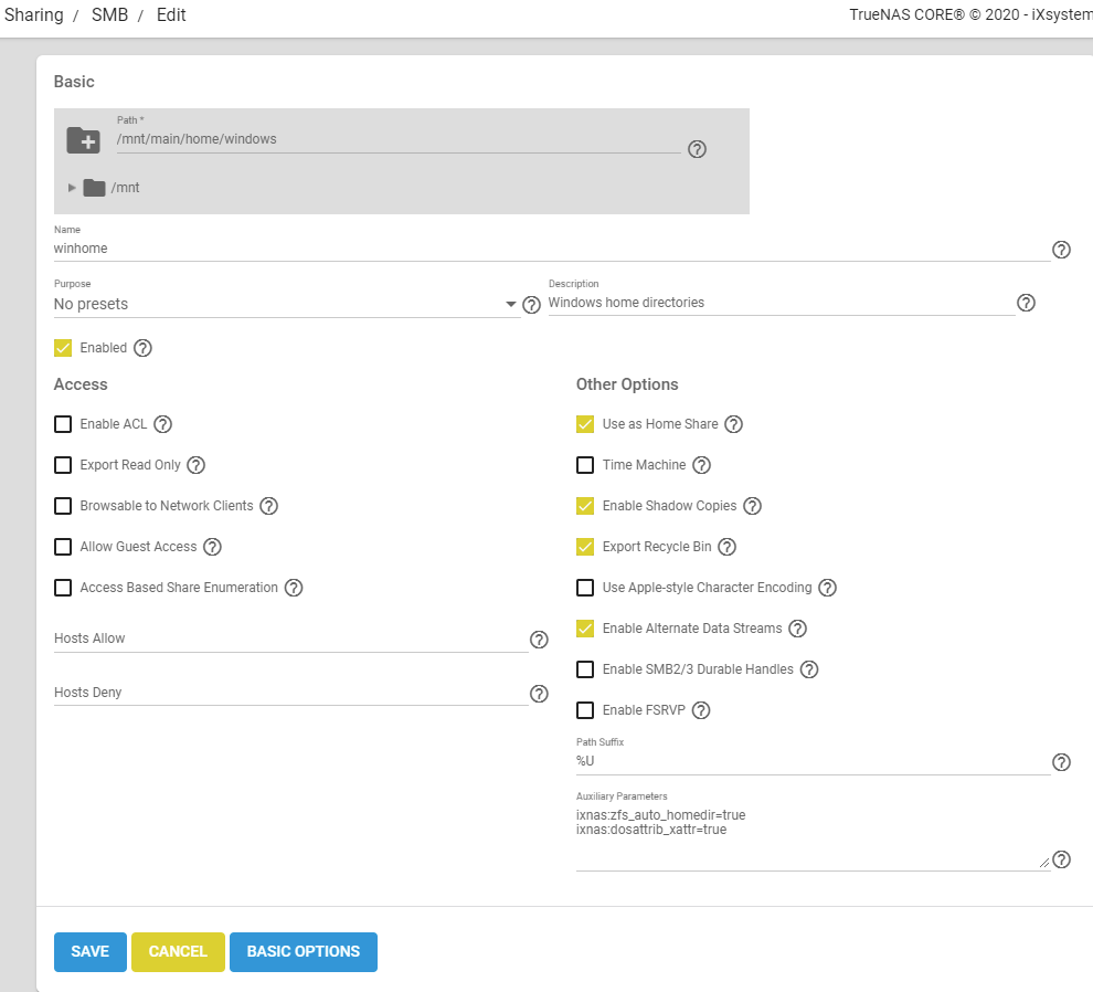

So, here's how I did my Windows home share. You can follow along, and change things to suit your installation.

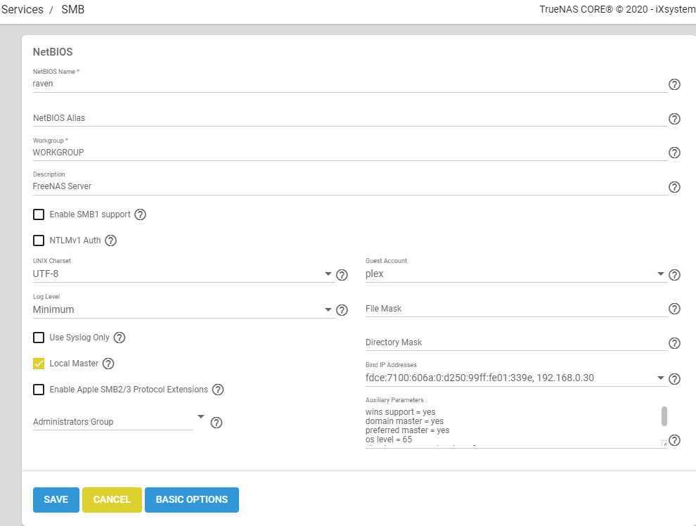

1. First, enable the SMB service. I use these parameters on mine.
You can leave the Guest Account, and Bind IP addresses at the default. What's important are the Auxiliary parameters. On my system, I use:
wins support = yes
domain master = yes
preferred master = yes
os level = 65
directory name cache size = 0
smb encrypt = desired
restrict anonymous = 2

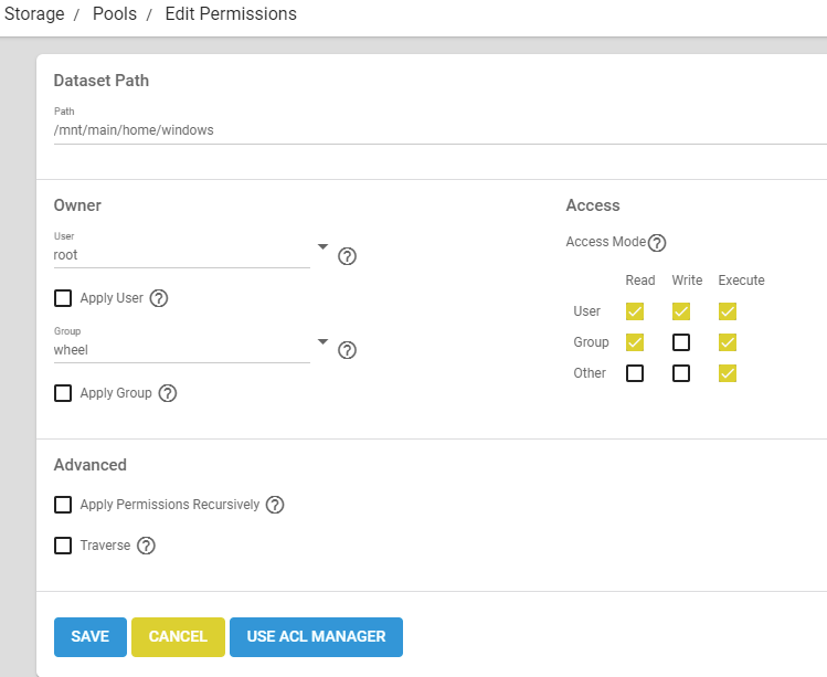

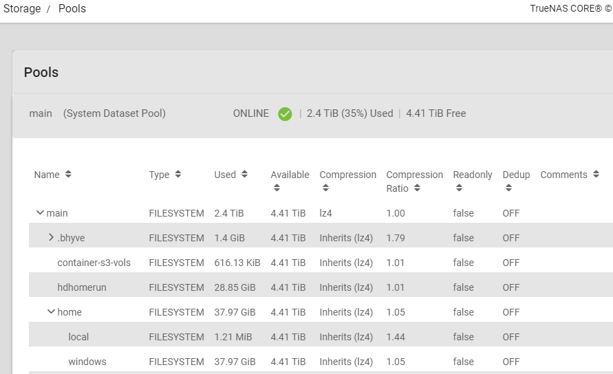

2. Dataset

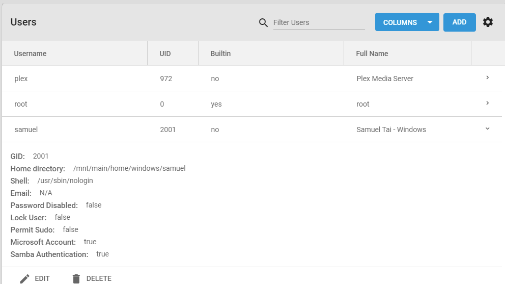

3. User
Note, the home directory is underneath the dataset from step 2. In the shell, the permissions look like this:
root@raven:/mnt/main/home/windows # ls -l
total 36
-rwx------  1 root    wheel   0 Nov 11  2017 .windows*
drwx------  8 samuel  samuel  8 Feb 10 09:18 samuel/
I don't use any ACLs at all, as ACLs confuse everyone to no end.

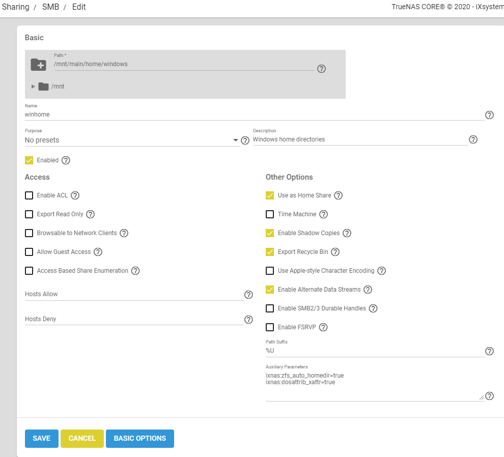

4. Share
Once the share is defined and saved, restart the SMB service to have the share definition take effect. I then map a share as \\<my server name>\samuel\, using "Connect with different credentials", and authenticate to the share as the samuel account and password.
